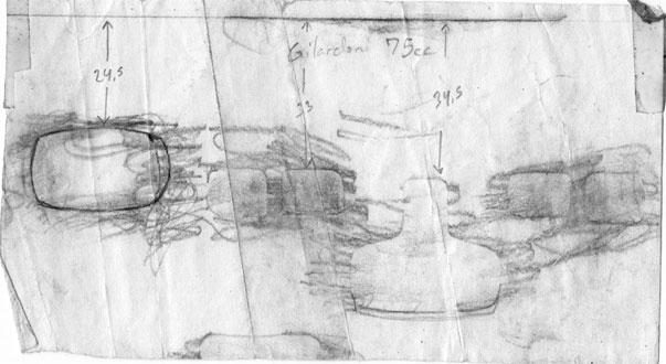

Gilardoni 75cc (47mm) (Reed-valve)
Gilardoni Reed size vs. Polini 4 petal
Gila Ports
Gila ports.jpeg Cil64-resize.jpg Cil65-resize.jpg Cil66-resize.jpg Cil67-resize.jpg
Distinguishing marks:
  • Reed-valve
  • Square cooling ribs
Pros:
+ Reed-valve
+ Fast 75cc kit
Cons:
- Piston doesn't have the pin in the center
Description:
Special points of interest:
  • Minarelli Vertical intake fits without modification.
  • Minarelli AM6 (Aprilia, Rieju, newer Derbi's etc.) reed-valve fits without modification.
  • A lot of people say that you have to replace the piston with a Metrakit or Airsal piston, because the original piston isn't suitable for right-turning engines because of the off-center piston-pin.
  • Angled exhaust port.
  • Crank-case needs mod-work to fit cylinder.
