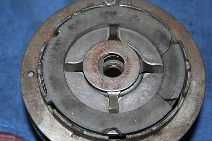

Yes to what graham says that the stock vario clutch is ok for stock and middle of the road builds. Where it begins to suffer is when you start adding pipes and really twisting the RPMS up tight,
The components begin to fail in three ways. First the composite clutch disc crack and break from excessive RPM or the locking ears start to shear off the disc from mods to the weights in the variators engagement point or the removing of more than two thrust balls from the thrust plate to delay engagement and gain initial higher RPM at take off.
Another way the stock variator clutch well fail from performance mods is that the higher RPM stresses the clutch locking ring and causes it to snap followed by the shearing off of all the clutch disc ears. This is especially prone to happen when the builder has removed the primary starter clutch shoes to once again gain that sweet sweet clutch slip off the line .
I have in the past built in some extra support post on the locking ring to help keep the locking ring from warping and snapping due to the empty space left by the missing starter shoes. It worked good for a long time but eventually snapped.
The third week link is the the clutch bells center double"D" hole that locks onto the crank shaft. Variator mod and high RPM Wheelie engagement will cause the center of the bell to "round out" or to snap the center out completely.
I have read on here that people have had success avoiding the "rounding out" by tack welding the double"D" washer to the clutch bell as it gives it double the surface area connecting to the crankshaft.
That method is great but it wont help when the cent decides to just snap out. It's all going to go.
