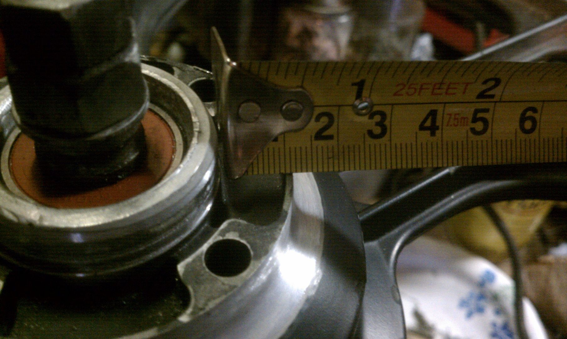

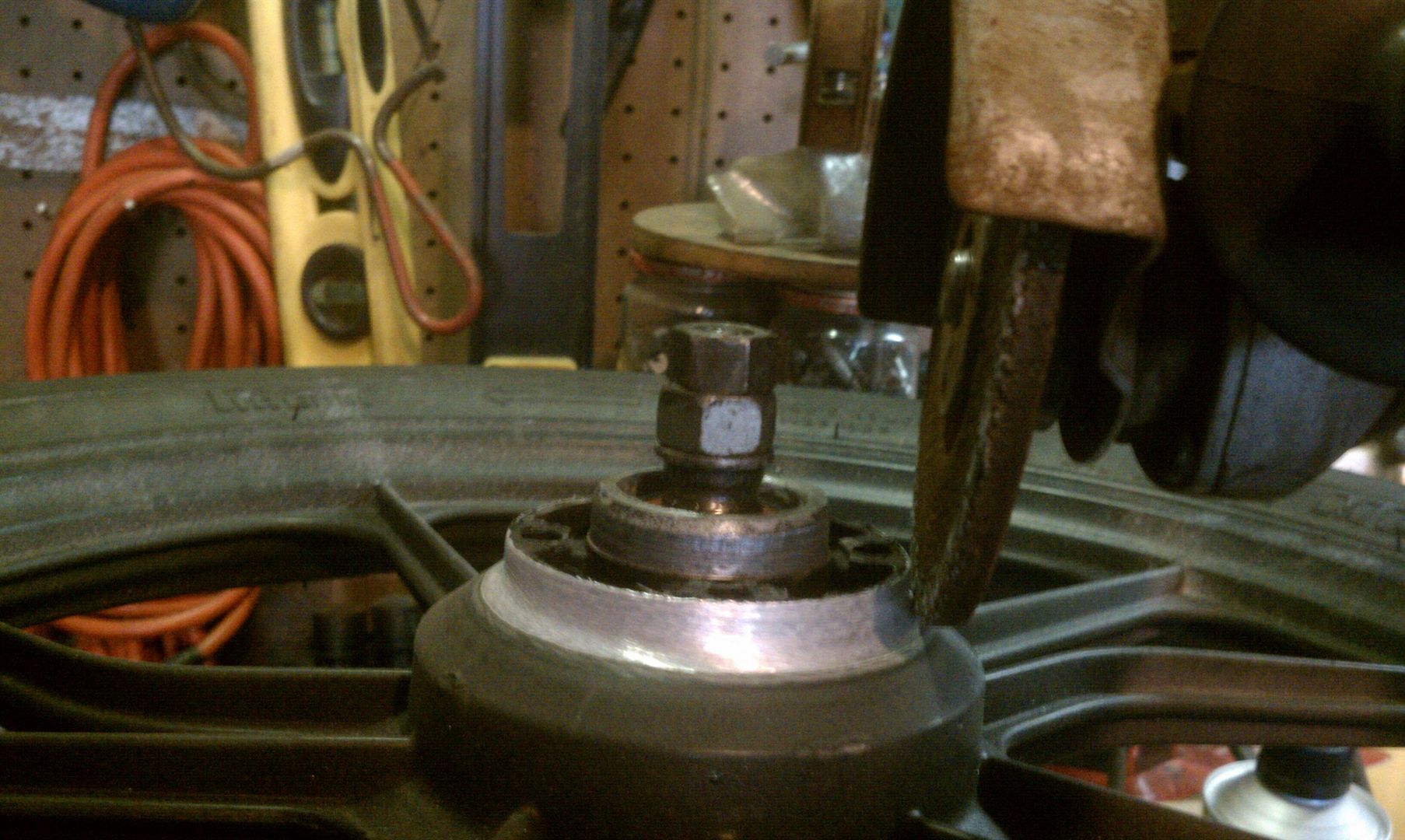

As for grinding the rear wheel down for the 20 tooth sprocket, yes, you absolutely will have to do that. I have done it a few times now and have a method that works great and ends up in a nice even surface.

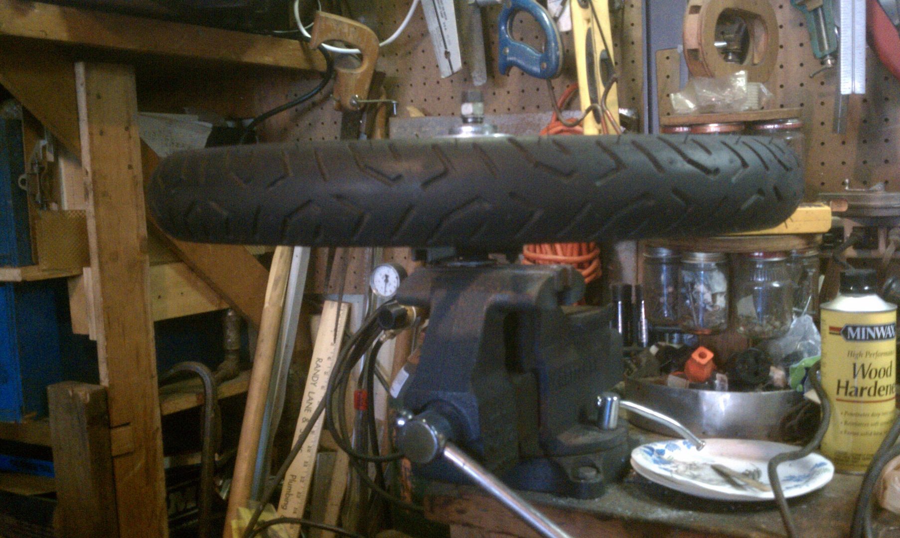

Mount up your axle in a vice so the wheel can spin freely

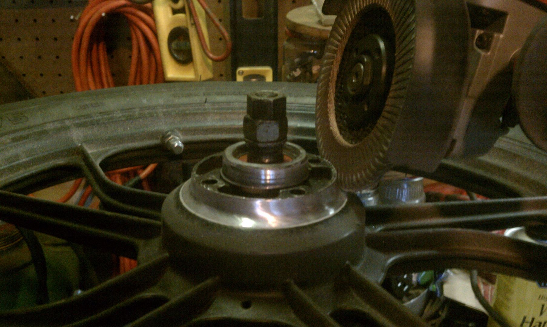

Get out your angle grinder. Take down the majority of the material needed to be removed with a hard grinding wheel. The wheel should be let to spin, this will make for an even grind all the way around.
Not completely necessary, but you can use a sanding flap disc on your grinder to give a nice finish.
You will have to go this far to clear the chain links, but try your best to not go any further than you need to! Check your clearance with the sprocket and a small chunk of chain. A little over 1/16 of material is left over at the web edge. Don't worry, it's perfectly strong, all of the torque is still applied at the bolts and bolt holes, which haven't changed a bit.
