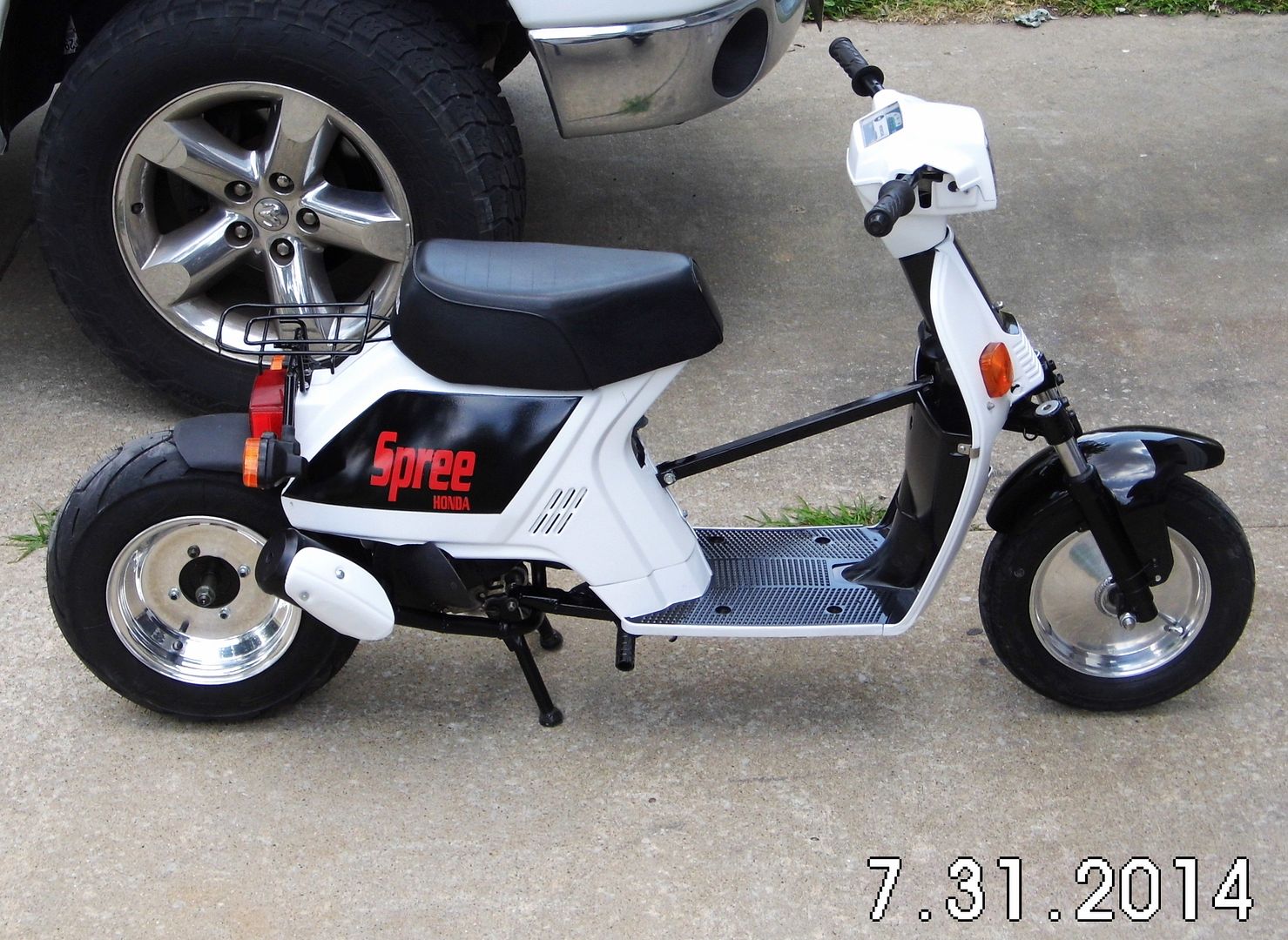

Here's a 85 spree I built with a 80cc BBK GY6 hard tail..
