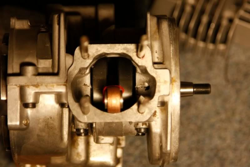

now that my case is completely apart. i want to do some touch ups on my case match.
im wondering if the boost ports need to clear the cylinder skirt.
how far is everyones ported back in the case?

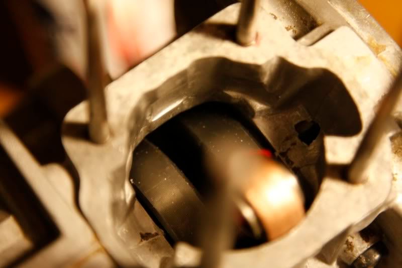

take them all the way back to the crankcase. here are my cases.
