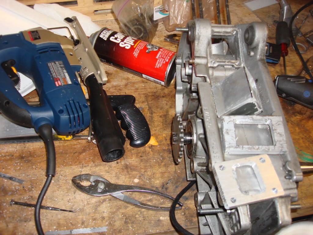

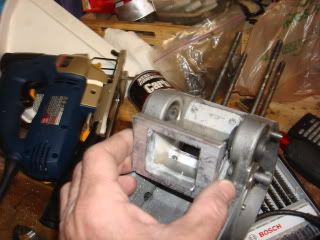

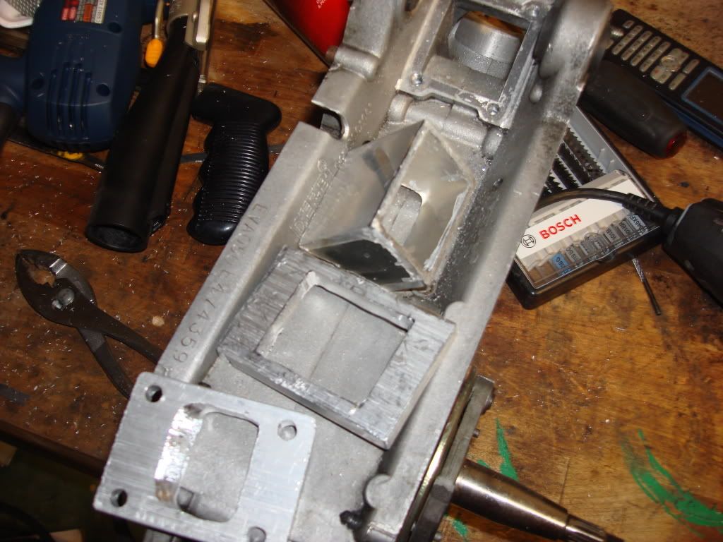

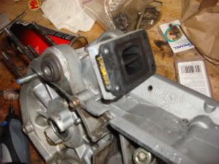

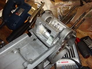

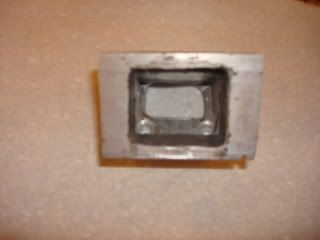

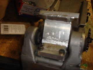

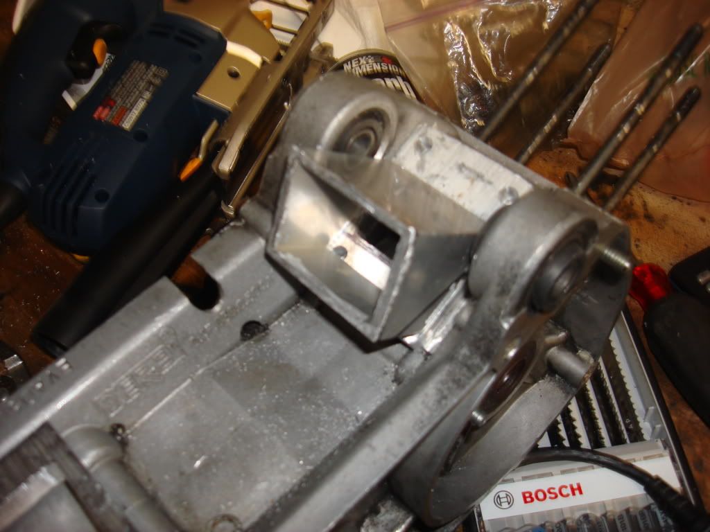

I have one of those 25mm intakes for a flat reed to run the bigger reeds. Anyone who is familiar with them has probably dealt with the shitty cast quality of the part. I had to re-tap the holes because I looked at them to hard and the bottom seating area wouldn't seal properly, slightly warped. So after having material welded to get a better grip with the new threaded holes and sanding the bottom it worked. I still needed another one for another engine and rather deal with it again I made this out of some scrap metal I got from onlinemetals.com

I sanded my intake and reed sealing areas on a piece of glass yes you should square and true the parts.

nice intake dan. Hows the angle?
Re: Derbi Intake, Check it
Good, fit like a glove.

After I get the welder set up. The guy i've been using is going to help me learn so I can do it myself. Once I get back from Inverness I'll get some gas and start practicing. I still have to make a top plate,drill and tap some holes. I'll make one for you Ed

wow, nice job. since you went that far, you might as well make the carb mounting plate yourself too so it makes the carb sit level. then you can still run the plastic cover and nobody will know the insanity that lies beneath it.

Thanks guys, I got a little discouraged when I started cutting and the aluminum was laughing at my old jigsaw. I got medieval on it with the Ryobi. I also learned to cut slow to save a blade from clogging. I'm doing the plate after I get back from Inverness then it's testing time.

How is the clearance when its in the frame?
I hate how cramped it is in there.

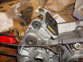

manifold looks good, i'm a bit confused though...
about the motor, i know its a flat reed, but where's the pedal shaft. even the flat reed revolution motor i've seen the countershaft doesn't look like that. just curious.
Its not hard to make the pedal disappear :)
Colby,if you saw Toni's Revolution motor it's one I got from overseas. They are a little different from the US Revolution motors. The euro models have gigantic transfers and a little different stroke length.

i've got access to my own revolution.... and its got a sprocket that bolts onto the shaft with 2 bolts
