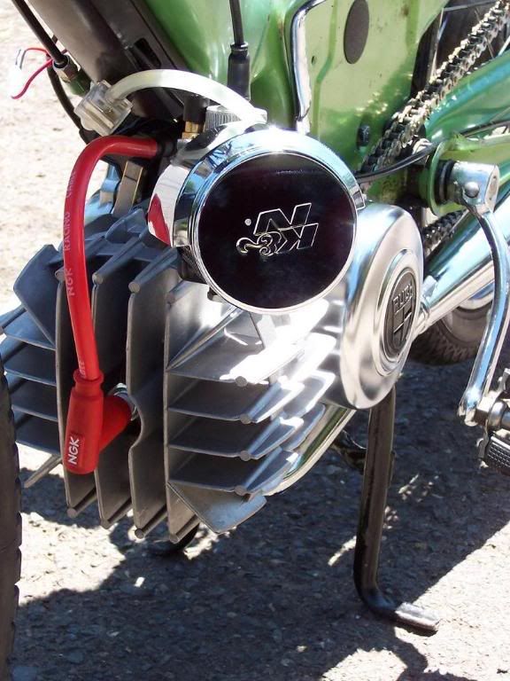

Looks awesome. If I didn't have a Destroyer already made for a slanted exhaust port, I would probably be inclined to get one of these...

I am really impressed with this kit. it's basically a 72cc cylinder, 46mm bore.
we had to grind the case a bit to make the sleeve fit, actually. just a hair all around though.
