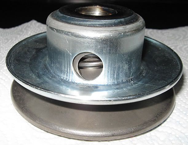

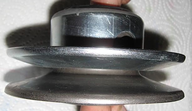

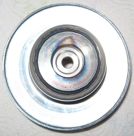

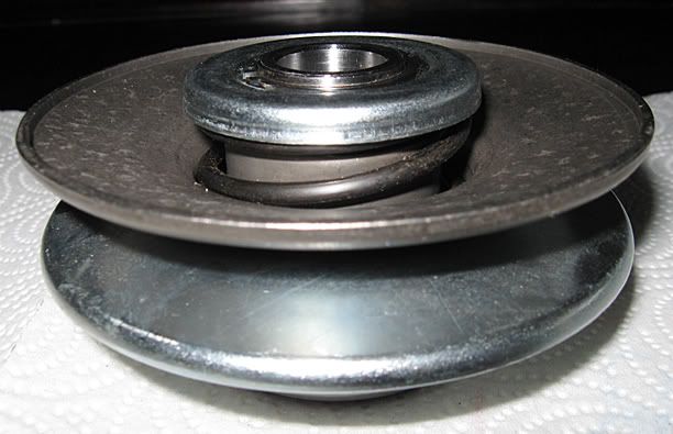

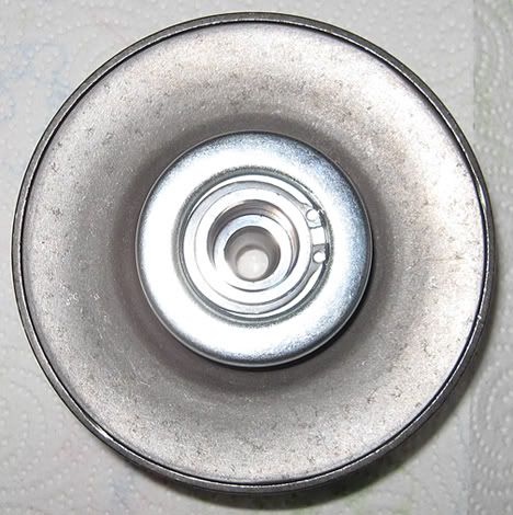

Second, I got my much anticipated brand new Honda Camino rear pulley in the mail from Belgium!!
Got it from a guy I met on camino-tuning.be - he bought the last one from his local honda dealer and shipped it to me.
144 Euros shipped.
Now I get to run my TJT vario (My stock rear pulley was so shredded that the TJT wasn't smooth at all) that has been sitting in a box for far too long ;)
The specs:
A touch larger than the stock hobbit rear pulleys (that's awesome for better top end)
Completely different design and internals.
Here are the pics:
Front
Back
Right Side Up
Up Side Down
From the side
With my stock gear shaft in place and my honda hobbit clutch puller tool installed - Looks like it's gonna work!
Side by Side comparison - TJT vs. Stock Vario & Stock Pulley vs. New Camino Pulley (And one stock pulley taken apart)

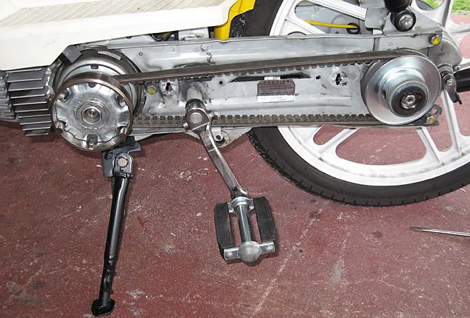

On the Bike - Fits perfectly. Had to install a new belt... probably time as the one that was on it is over 30 years old with many many miles on it...)
Before this change the bike GPS'd at 55.5 on my friend's handheld GPS unit.
We'll see what this setup does once it stops raining.

Hmmm, looks like your belt could/should be sitting much higher on that rear pulley.

Yeah Tommy, that's why I had to switch to the new belt.
The old belt had worn down and was a bit thinner so it sat even lower in the pulley and had some slack too because it was stretched out.
Maybe I'll look into finding a bit wider of a belt.
Either way, it's gonna be better than it was I'm sure...
