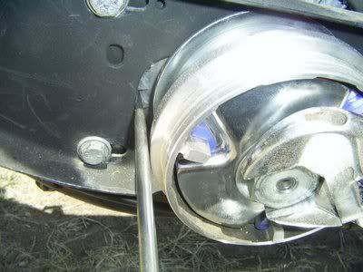

That nut is a pain because the part its is on spins.Any tips to getting it off?

Im looking for the bushing people are talking about grinding the tab off of.
Re: Vespa grande variator
use a strap wrench or a piston stop (rope) to keep the engine from turning over. the bushing is in between the two pulley halves.

Here's how to remove the front variator. Just wedge a flat head screwdriver between the flywheel fins and the frame.

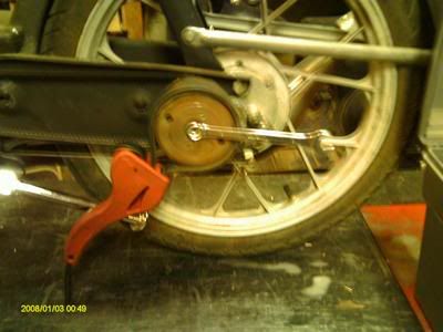

To remove the rear clutch, use a strap wrench.
