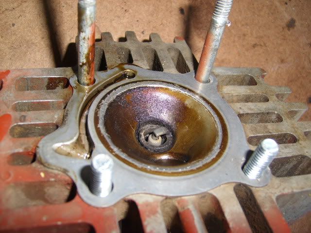

After having carburetor issues, I figured I’d pull off my Athena kit to see how it was holding up. Piston clearance had come up in a conversation Saturday night and it turns out it was a good idea to pull the head.
The piston isn’t always hitting the head, I only heard it on long, wide open downhill stretches maybe when the rod and piston expand a little more than the head and barrel.
Anyway, this has me researching ways to improve clearance like squish band, adding head or base gaskets…

that is some serious serious contact there. also lots of yucky looking carbon on that piston.
just do what i do with the athenas and cut your own sqiushband.

Didn't know this was an issue with Athena kits! I would try more base gaskets first because it is the easiest and most reversible fix. Peter, do you have any pix of your Athena kit?

Did you just move down to a smaller jet? To my eyes, the plug looks lean. You might be able to case match that as well.

That's such a clean squish band. Did you do it by hand?

cutting squishbands by hand is easy and has been done for years. i only did it out of necessity. it took like 30 minutes.

Hey Peter what tool did you use to cut your squishband?

If you add base gaskets you will change the port timing slightly.
You are better off working on the top, either a thicker head gasket or by machining the head for clearance.

a dremel and some sandpaper :)

That's what I got started on it with. Mostly using the mark in the head as a guide.

trace the headgasket with a sharpie silly!
