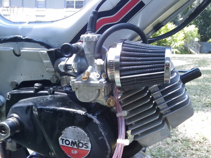

Yeah the VM series that JCAMS orders for people(I have one myself from JCAMS) are different than the one you posted. The size of the inlet for air where the air filter goes on is like half the size of mine.
Check this picture out for reference. Notice the massive diameter where my air filter goes on. I have a 20mm and mine looks massive compared to the ebay one you posted. Trust me go with the VM20 for 30-40 dollars more and you won't regret it.
Re: 21mm Mikuni

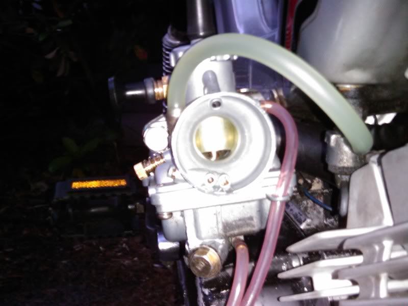

Post a pic of the front of the carb with no filter. I think for the price of this carb I will be very happy. It will still flow better than the 16mm I have now. It should be very similar to a delorto 21.
Re: 21mm Mikuni
Here is a pic of no air filter. The opening is probably more than 1 1/2 inches in diameter. The one you posted from ebay kinda of looks like a stock application from Mikuni, like a stock delorto as apposed to a 19mm delorto. I am not saying that is a bad carb to run I just know the VM20's and the TM24's run awesome. Either way you should gain something. More fuel&air is always a good thing. haha

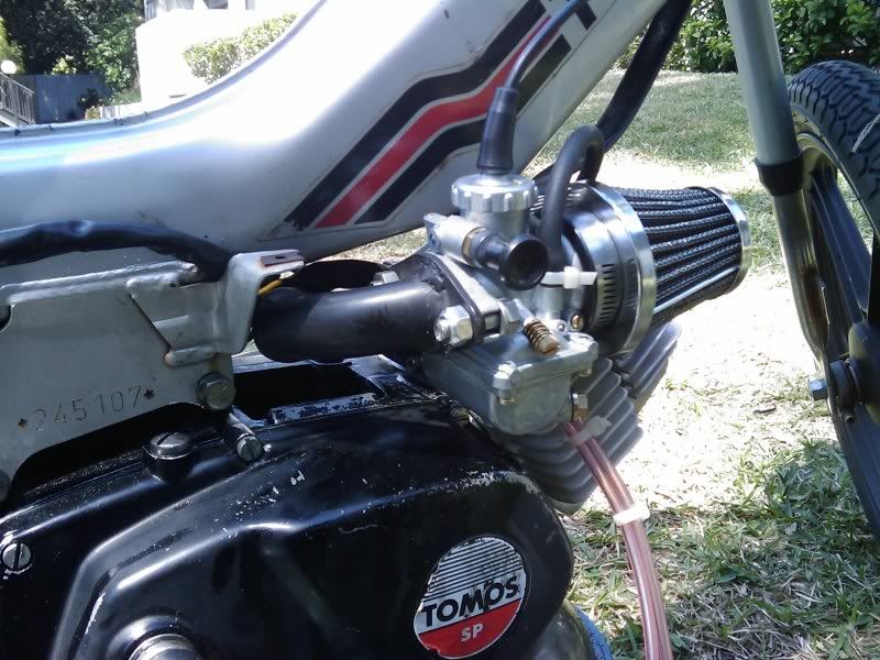

i want one of them setups how much was it?

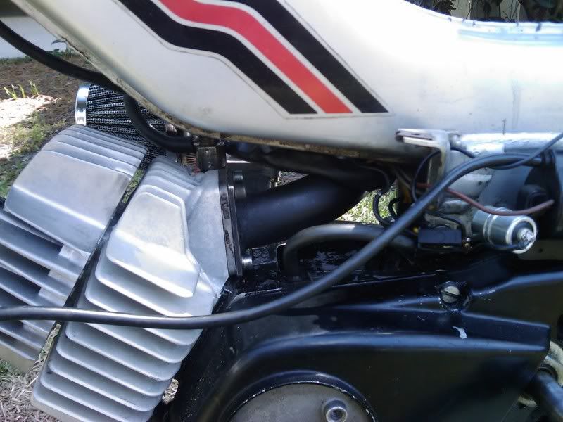

can u post a pic of the manafold only.the carbs in the way.i cant see.
Re: 21mm Mikuni
I don't have a pic of just the manifold. I put the setup on so quickly I never got a chance to take a pic of the manifold by itself. Either way here are the best pics I have of it. And pricing I will leave to JCAMS to talk to you about. I don't know if he charges different prices for different applications, but my setup came with everything I needed to just put it on.
This is the other side.
