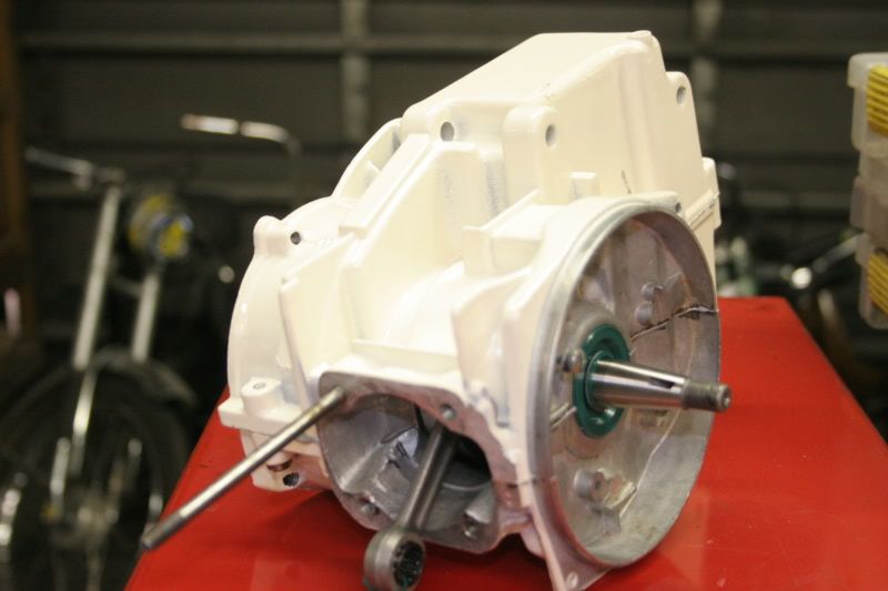

Search the gen forum. I think Nash or A-ko just did his E-50 case white and can do others also for cheap if you ask him.

actually that was me that did the white e-50.......... i'd be happy to do your case black provided its not in terrible condition for little more than the cost of some black paint and shipping... lemme know!

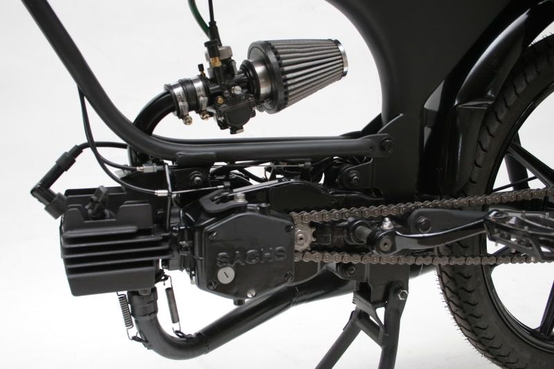

Re: Powder Coating Cases
yes!
right up my alley.
God they build beautiful bikes.

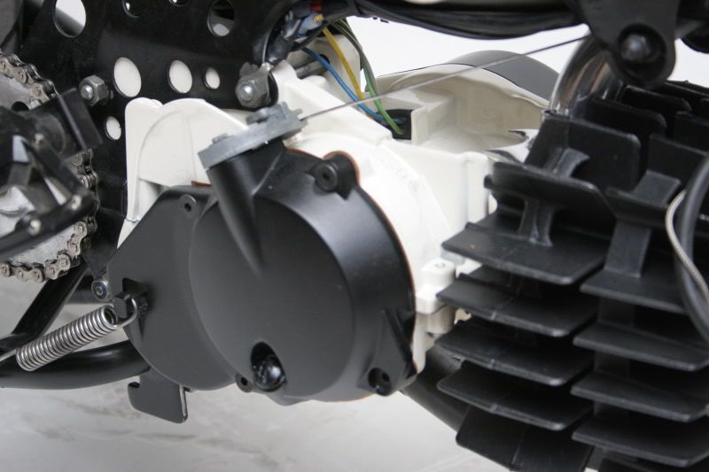

I.R.E. Mike Pee /
Did mine and a 15 PHBG. Check the pic.
^ that picture really does it no justice, it looks 100% better in person
Oh my... Cincinnati Bengals moped?
I.R.E. Mike Pee /
Yeah, crappy cell pic. Maybe I'll bring my good camera to the shop and take pics tonight. The cases are fresh from the oven in that pic too, with all the tape, etc on them.
