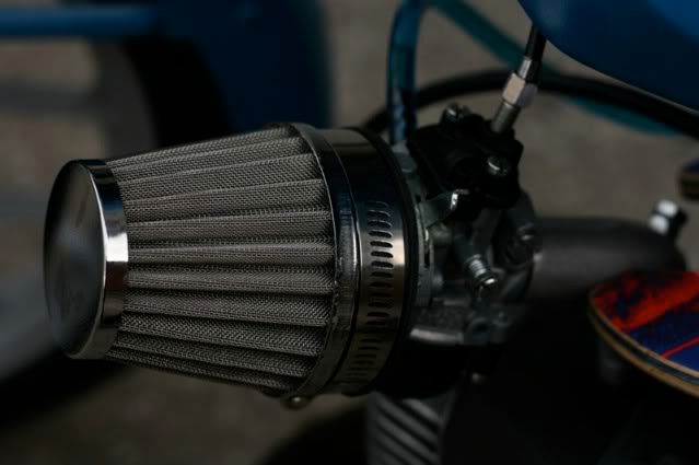

I'm running a Dellorto 15.15 SHA (#80 jet) with the "bendy" 15mm Minarelli/Puch intake that 1977 sells. I put on a K&N style metal mesh screen filter. I'm also running the Puch LeoVince exhaust.
My pipe feels like it hits right after the variator is all the way open. Obviously your pipe will hit differently since you have the Mamba. One thing I did notice is that my pipe hits FAST and HARD due to the gearing I'm running right now (14x32). I feel like I'm getting to just over 40mph. If I had to guess, I'd say 42mph. It seems like you should be getting a lot more than that since I remember you saying that you are running a smaller rear sprocket.
