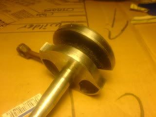

Re: cut cranks, though, you might find the attached picture informative.

oh, thats cool. i actually thought that there was a small notch going down the crankshaft balancer weight thing. does a stock shaft/rod look anything remotely similar to that or is it way less radical in design?
Re: Cut crankshaft
James' pic is a stock crank mine is a pic of a stock cut crank and it should have read 5 mil on the left, 10 on the right meaning that's how far back I cut the "ramps" from their stock position. if you look at James' pic again you'll see they form a pie wedge shape, where as when cut, they are almost straight across. hope that makes sense.
