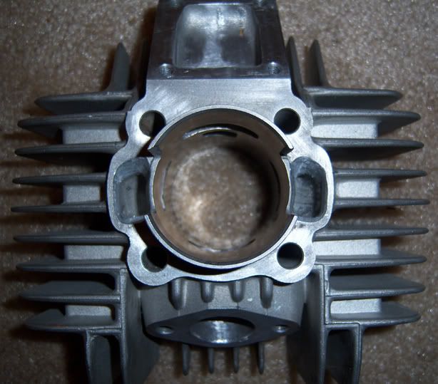

well kinda... 1.5 maybe, hah... anyway so I have been running an A35 topend on my daily maxi for a while now, that's fun and all but after building up a Trac A35 combo with an Alukit and 15SHA (I really just needed any topend but cheap as they are I was like why not!?) I realized that that that little thing has some serious kick, I underestimated it. so now to my upgrade. I saw that the thing has super modest porting, one transfer not much larger than stock, an awkward booster, and a basically stock exhaust. I guess the extra 20cc of displacement is where the power is at on this thing. so I obviously wanted more... just a bit. here's some picks and explanations, what y'all think?
The booster is small, so I opened it up a bit... could have gone bigger I'm sure but I'm only gonna be running a 16SHA, with a polini 4 pedal I'd open it as much as the _Rear Feeder Port_ Before

After

nice port work, im curious of any negative effects of shaving the piston crown the way you did, why wouldint you just raise the transfer ports a mm or so?
the rings may get more pressure at those two sides and maybe lead failure or somthing?

it's seriously a half mm, I couldn't really get a good angle to hit the transfers either. this way it keeps the uame angle of the ports just a bit earlier.
