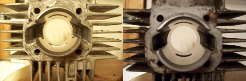

Alright, to redeem myself here a bit.....
50mph #3 cylinder vs Stock #3
Barely opened the exhaust outlet, raised and widened the port, lowered the intake and widened, etc.....
Re: porting pics before and after
Wow, white balance your camera! But that is still a VERY nice porting job! I'm not used to seeing open ports and I'd be too afraid at snagging a ring on that anyways!
I just buy the dremel brand buffing pads that come it two packs. They look like black or brown little scouring pads that fit on the quick change mandrel . 4 bucks at home depot for 2
