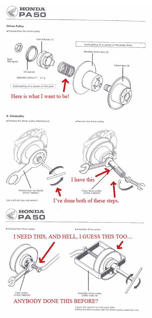

A quick question for those who've cracked open the rear "driven pulley" on a honda hobbit to install a TJT spring.
I might be getting a TJT variator... I wanted to be prepared.
So, I removed the driven pulley using my handy honda tool #07933-1480000 and it was super easy.
Upon inspection of the pulley, and upon looking in the manual I've got, I noticed that another honda tool is used in in opening the rear pulley to get to the spring inside...
First obstacle, I don't have a socket that huge for the nut on the back, it's gotta be a 26 or bigger... What did you use?
2nd challenge: find honda tool #07933-1480100... DO YOU HAVE IT?
Let's talk if you can help me out...

I made this tool for the removing it from the derbi.
Let me go get a pic.

Thanks Ed.
This pic should clear up what I need.
Re: TJT Vario Spring/Honda PA50II Rear Pulley ??
Looks like removing the pulley in the last step can be done on an arbor press or a hydraulic press or possibly in a vice if you are careful.

I heard you can order the tool from any honda shop. I also heard that tjt spring is way too stiff.
Its a easy tool to make.
Looks like you will have to make the tools just need to know what size the threads are research you have a welder :)
I used this tool with a slide hammer btw.

Yeah Tommy, you actually told me that once... so, in conjunction with my scooter shop friend, I might have found some other alternatives...
For now, I just wanna crack this bitch open!
Also, I plan to call the local honda shop where I bought my other honda tool... they actually had the PA50II clutch tool on the shelf all dusty and forgotten... I was shocked!
Ed, not sure I can see all the bits and details, got any more pics?
J

The derbi is alot easier to switch that out. The tool I made also removes the clutch same thread.
I will buy the spring as I want to snap a crank :)

The pulley puller was unavailable on www.bikebandit.com, couldn't even find the other part # try www.hdlparts.com
nooo, dont waste your money on that puller...
...give me one sec and i will type up a way to disassemble the rear pulley
hold the pulley like this:
i used rope rather than the belt
then insert a wooden dowl, or something similar, into the hole and beat down on it with a mallet. it just needs a sharp wack and the whole thing will come apart. it will most likely spring apart and end up somewhere on the floor but there arnt many parts to it so you shouldnt lose anything.
i actually used a piece of rope, but you get the idea.
then insert a wooden dowel, or something similar, into the hole and beat down on it with a mallet. one sharp whack should cause the pulley assembly to fly apart, it will probably spring across the room but there arnt many parts so you shouldnt lose any.

What ever you do be very careful to not bend the inside moveable sheave. It is very thin and very easy to bend. I speak from experience. They are impossible to find also.

Noogie, your link was perfect.
Cleared it right up.
