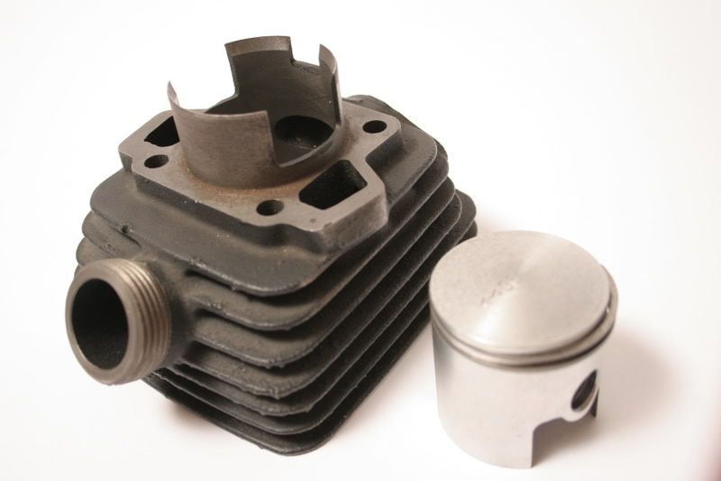

Garelli polini question
pulled a kit off of a garelli (it's new)
it says polini but kind of looks like this
https://www.1977mopeds.com/cgi-bin/commerce.cgi?preadd=action&key=574
what is the name of this particular polini kit?
Re: Garelli polini question
if it came off a garelli it could be the polini designed for garelli VIP engines.
This is the Polini Garelli VIP kit
Here's what the kit looks like. Cant be a VIP kit as its not tapered. I guess it doesn't really matter one way or the other. I had the initial idea of using it on my magnum but I guess itll stay on the garelli.
polini for a garelli NOI then. will not work on a puch.
Figured as much thanks. (intake/exhaust was the give away)
