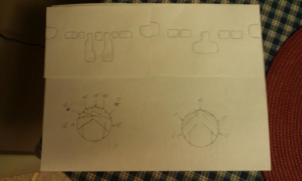

Figured since this was back at the top I would post a few rubbings.
Puch Polni 65cc (modified race porting)
The parma 85cc think I know why it hit at such a high rpm.

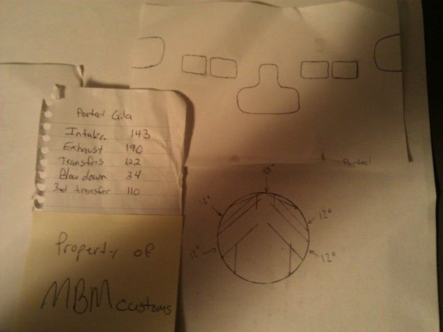

Matt Mahloch -- MBM Customs /
71.1 MPH Puch Gila
Stock Puch Gila and Stock Puch Polini
