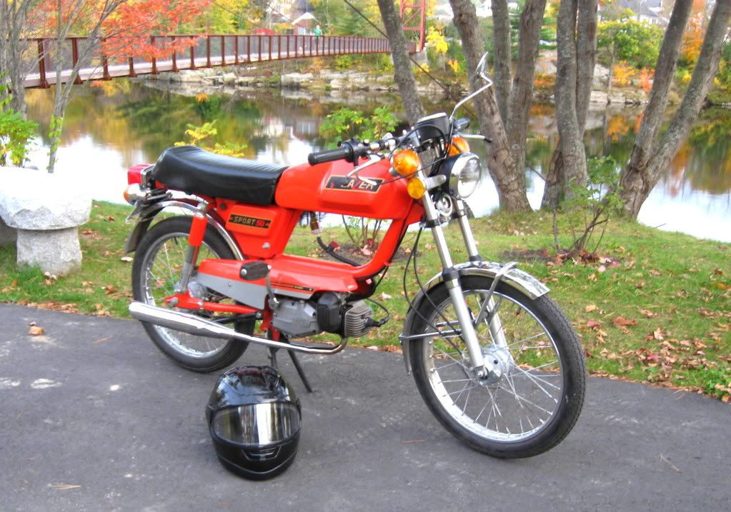

As far as I'm concerned the General Five Star/Lazers come with one of the nicest front forks I have seen. These bikes are built like motorcycles!! I have a Lazer with a Minarelli and its dead slow but super stable and well built. Kit it and go. I dig the rack on your bike. If you decide you don't want it I will gladly buy it off you. My Lazer.

Pepi - If my lazer had been that gorgeous I would have left it that color. Wow.
Too bad mine was a shitbox when I got it.
I'm gonna be adapting Peugeot 103 five stars to go onto my Lazer.
17" rims of any type can be made to fit. Just takes a little extra effort sometimes.
As for suspension, mine is stock. A bit squishy. At speed, big bumps can sometimes cause the back tire to hit the fender. I'd like to do better shocks someday... not sure what type I would use though or where they would come from...
