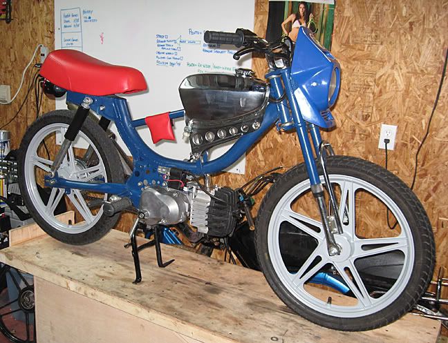

After a long break-in... I got my Pinto up to 64mph - as gauged by a Honda 250 Reflex. Side by side on U.S. 1. A red light was coming up and I had to back off, the bike, believe it or not felt as if it was still climbing...
1978 Pinto
1996 Korado cdi kickstart E50
75cc Gila
Custom Intake
18mm Mikuni - 20 pilot - 85 main - no filter
17x40
Simonini exhaust
Nifty "NEW" Five Stars
2.5" Gazelles F&R
Here it is...
Gonna be all red when I get it powdercoated.
Possibly chromed wheels... still undecided.
P.S. - I took off the plastic fairing since this photo was taken.

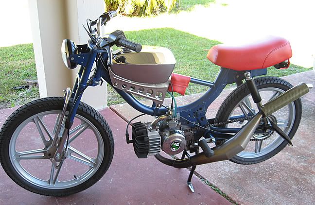

JCam, do you have a picture of the other side of that pinto? Looks really nice, btw.

Here's a pic I just went outside and snapped for you.

Nice job on the intake. I wanted the pic to see where you put the carb. I have a Pinto that I'm trying to keep stock looking, and would like to keep the plastic sidecovers. Now where to put the 20mm PHBG. Hmm...
Did you have to add aluminum to the case for the Gila?

Yeah, my friend Jamie made the intake.
Works great.
No, I did not have to add material to the case... just a lot of dremel work to make it fit.
