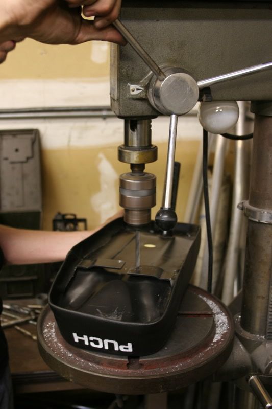

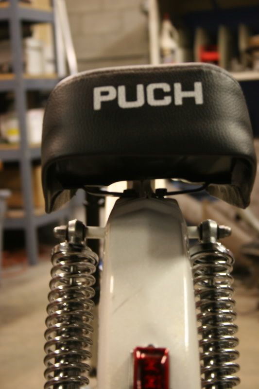

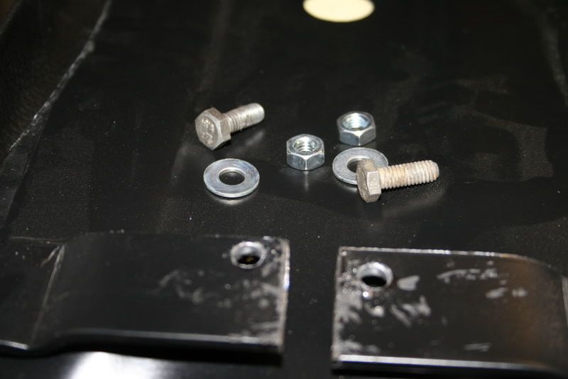

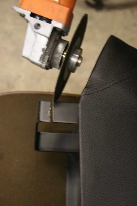

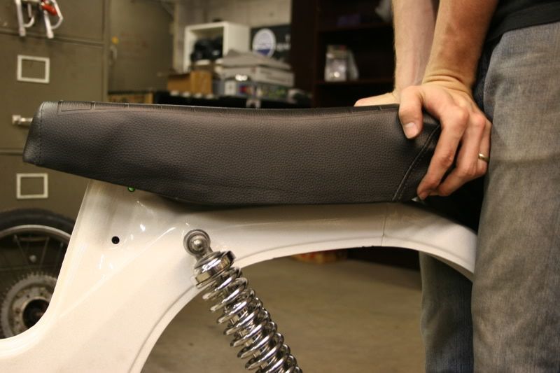

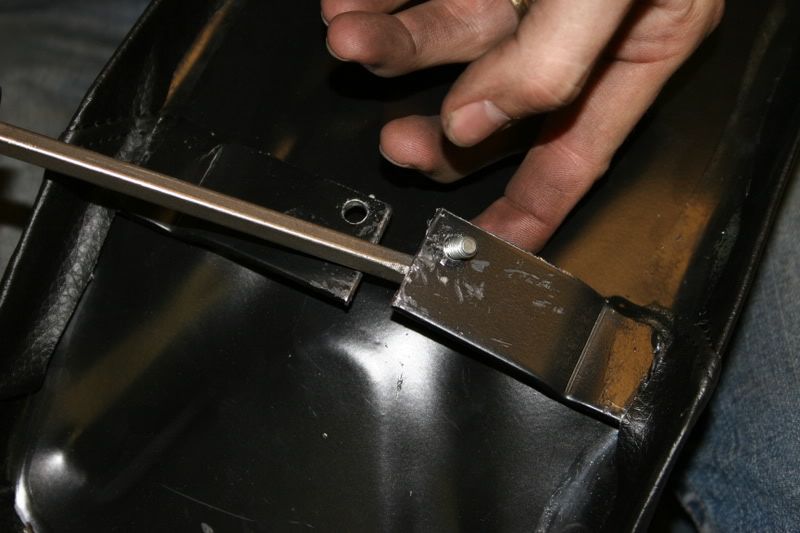

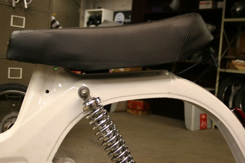

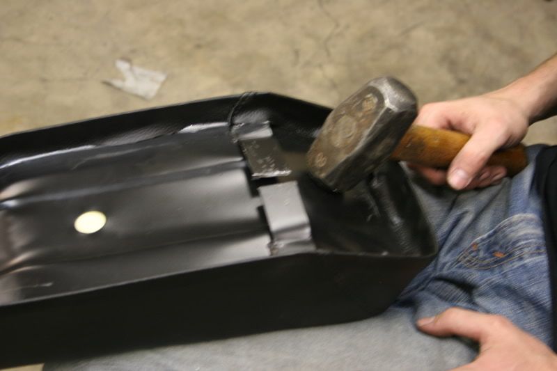

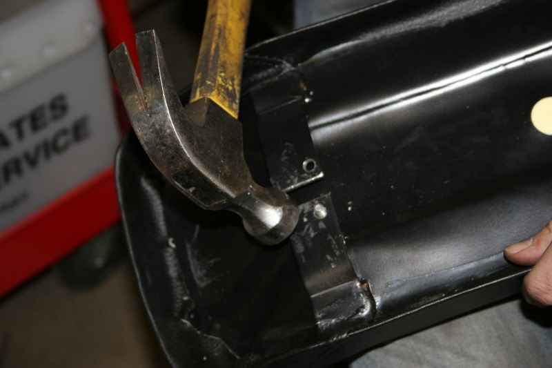

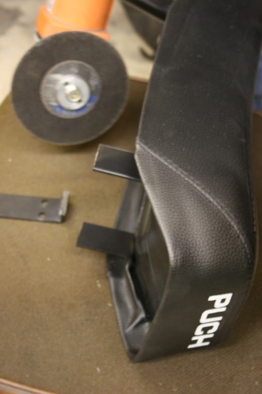

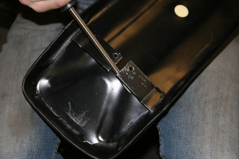

I have gotten a lot of calls and emails about how to mount super low puch long seat. Heres how. Credit this idea to Nathan Kiehn.

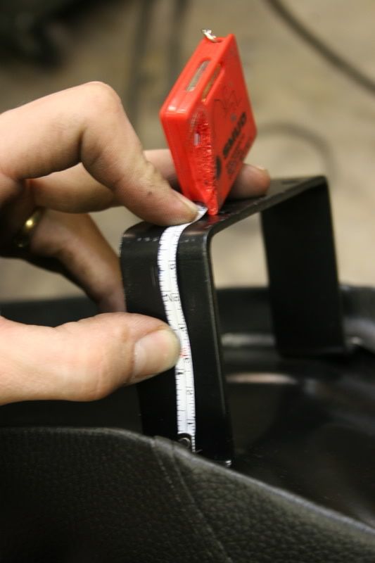

About two inches

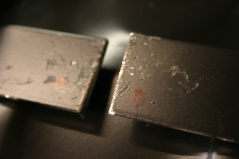

Mark with sharpie

You can also do the same, but mount to the shock bolts instead of hammering into a horizontal.
Re: Performance your puch long seat. Hella pics.

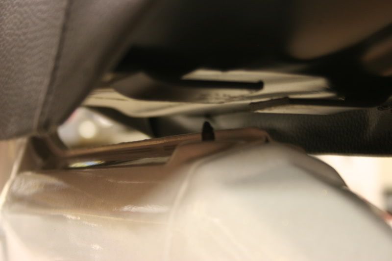

rafter ur seat tube weld is gonna snap forcing it down like that on that type of aftermarket maxi seat man!!!!, it happened to mine after a few months.
i can't tell how far away the bent tabs are from the frame but it looks like 1" from the pics, i'd put a spacer in there to make it perf.
awesome step by step pics man, also good idea.
Elliot: Five seats mounted like this have not broken seat posts yet in a year. But we do not ride like you do. You put a beatdown on your stuff. It could totally happen at any min though.
The last pic shows what it looks like done. But when you ride it for a while it gets lower. The tabs bend in from the weight of your butt.
Mounting to the shocks would work but then you could see the mounts. I don't care for it.
David: This mod adds + one performance point for looks and none for speed.

Here is how I did one recently
I've found that it is ideal to have the the bracket be about 1-1/8" tall. That keeps the seat nice and level and doesn't put any pressure on the post.
I then marked the holes from the bottom of the fender...removed the seat....drilled them out....put the seat back on....and bolted it down.

One more picture of it on the bike

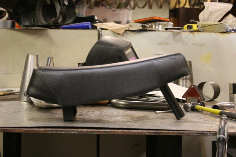

You could probaby leave the tabs a little longer and bend them over pre welding. Would give you more weld/surface area for strength.

i always just cut the mounting thing off the newspaper rack and weld it to the seat pan

i just kept the tabs vertical and then drilled horizontally through my rear maxi feder and ran a bolt through it. Thats the best way to do it imo besides hacking and welding a fabricated bracket.
Putting them horizontal like that is just going to prolong snappage for a little bit longer but they'll probably still fail especially if you're goin' dubs
i don't see how they will snap seeing as though there resting on the bolt it self taking tension off the bends. this mod is solid as it get's without welding.
