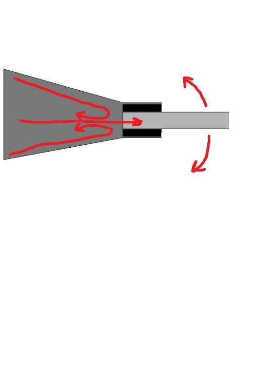

The vlx exhaust style coupling was my first idea, but i came up with a few flaws that i would like to work around.
The bushing that is used to keep the pipe sealed leaves a ledge that in a expansion chamber im afraid would reflect part of the reverse pressure wave back, making the pipe less efficient. also the bushing on my vlx is leaking bad, but it could be because its from 1978...
there a quick drawing of my concern.

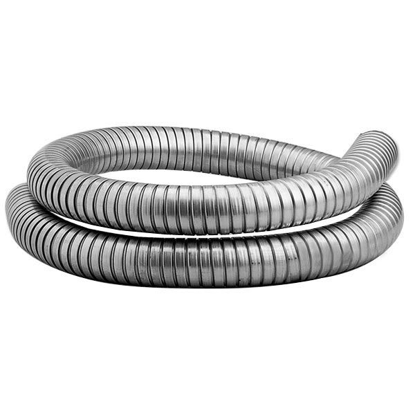

heres a pic of the flexible exhaust tubing.

The flex exhause pipe does not do well if flexed often, it is bendable so a DIY person can route a fixed exhause on their vehicle without a pipe bender. It is spiraled steel with a channel lock on the spiral so it can come apart with no warning.
