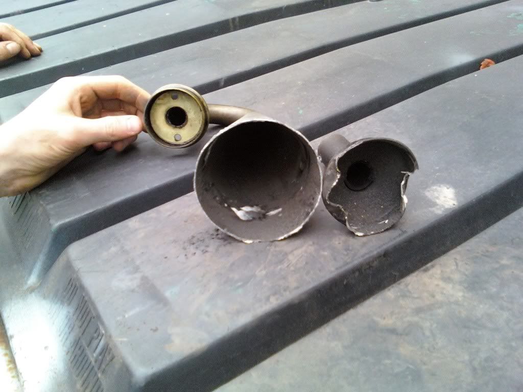

Just thought I would share my experience with removing the "restricter" from my Estoril.
First the basics... Puch Maxi, 80 Gila, home made intake with 21mm Delorto and I started with a 8P.
I wasn't happy with the 8P... loved the top end but most of my riding is around town were low and midrange power is more useful... at least for me.
So I put on the Estoril.... great low and midrange and I was happy... for a while.
But the Estoril really tops out early with a 80 so I thought I would try removing the restricter I read about on the threads.
Only took about a hour to cut it open remove it and weld it back up.
Oh... it really doesnt restrict the flow... if you look at the pics what it does is remove 3 inches of the convergence cone and reshape it slightly and add the 3 inches to the stinger length.
I expected a slight increase in top end power with a corresponding loss in the low end... wrong.
What I ended up with was a honest 5 to 6mph increase in top speed and a big increase in the midrange power. I didnt notice it hit the pipe at any higher RPM than before I modded it but it sure hits the pipe harder now.
Probably the best hour I spent working on my ped in a long time.

so did you remove that entire piece, the second pick? i have seen other people do this and they say to remove just the three welds and the ring. if all i have to do is cut it open and remove that one piece that seems really easy.

I've done this, It's pretty easy if you have the tools, but does require some skill. The welds on the baffle inside are a pain but it comes out. make sure you align the pipe back up correctly or the silencer will not bolt back on right. Also cutting the pipe in half and putting it back together ruins the hard clear they had on it from the factory which is pretty thick. So you'll be able to see pretty quickly if anyone has done it to their pipe or not.
Awesome!
OK... yes I removed the entire piece pictured.
Yes all you do is grind away the 3 small welds and the entire piece comes out.
If its any louder it minimal
In my case I didnt notice any loss of low end and a increase of mid and top end. But how it reacts with a different kit or smaller kit I cant say

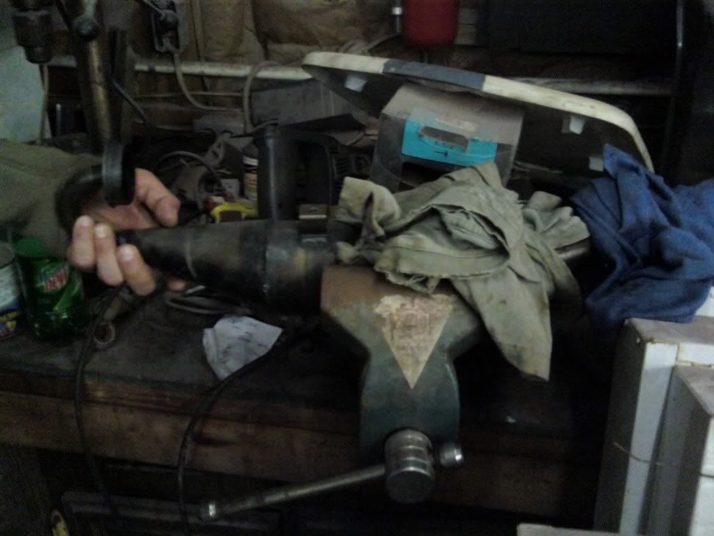

heres some pics i have from when a buddy did his...
Re: Awesome!
So did you remove that tube altogether or just do something to it? Is that all there is to it?
