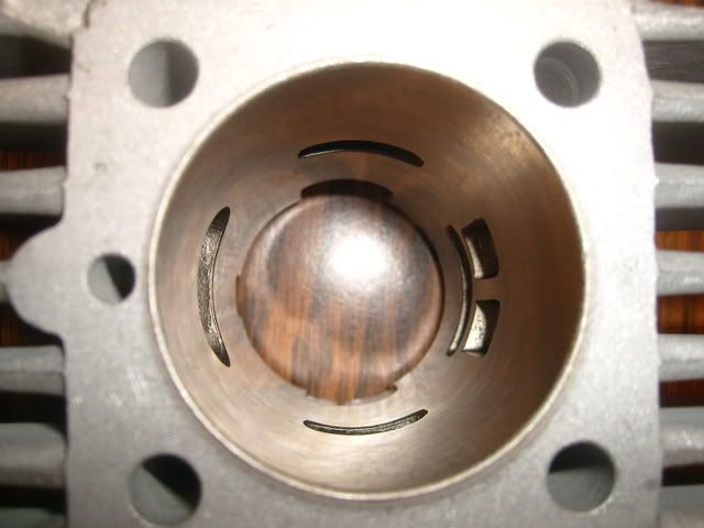

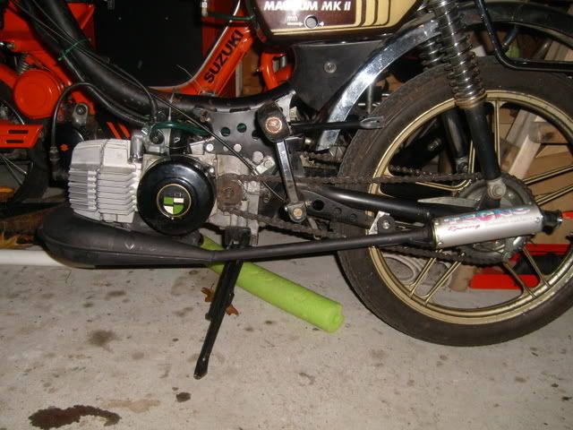

I got everything in, and included a few pics. Overall, I really like this kit. Has mild transfers(I did casematch) and everything fit together like a dream, no added base gaskets or the piston hitting the head. I got it all back on the magnum, and started with a 90 jet just for the fun of it. I Let it idle till it got warm to the touch, and idled great. Obviously I'll feel the main jet when I ride it, but it sounds great on the stand. I'll update tommorow night when I get to ride it a little more. Joe

thanks for the picks I ordered the same kit and it will be going on a magnum same as yours. what carb and intake is that?
Re: Hows my setup?(puch)
"dellorto SHA 16/16 carb with intake"
Read the original post carefully...

hey joe! I got that same setup and it's funny, i installed that sucker tonight too lol.

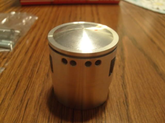

Do you put the piston with those holes in it up towards intake or towards exhaust? I would guess exhaust right
And i cant get mine to idle, not sur what problem is. I had 82 in there and running a 74
I have puch, with proma gp, dell sha 16.16, and airsal 70 almost exact same setup, how far is ur mixture screw in or out? Tryig to get this thing goin good tonight to make it on a ride tommrowo

holes in piston face UP

Holes are boost ports and point to the intake!

yep, holes face up. The intake is actually 15mm, but I don't dare drill it out considering how thin it is. Today I'll check for air leaks and start to get it moving under its own power. Wish me luck. Joe

1. SHA carbs do not have a mixture screw. They have a throttle stop screw to set your idle rpms. all it does is stop the slide from closing all the way.
2. Your piston is upside down. The holes point up.

I went down to an 83 because of the crazy 4stroking the 90 was. Low end is much better than stock, but still breaking in. Once its broken in, I could mess with the timing, but also plan on switching exhausts. Anyone have a pipe they want to trade for a circuit?
