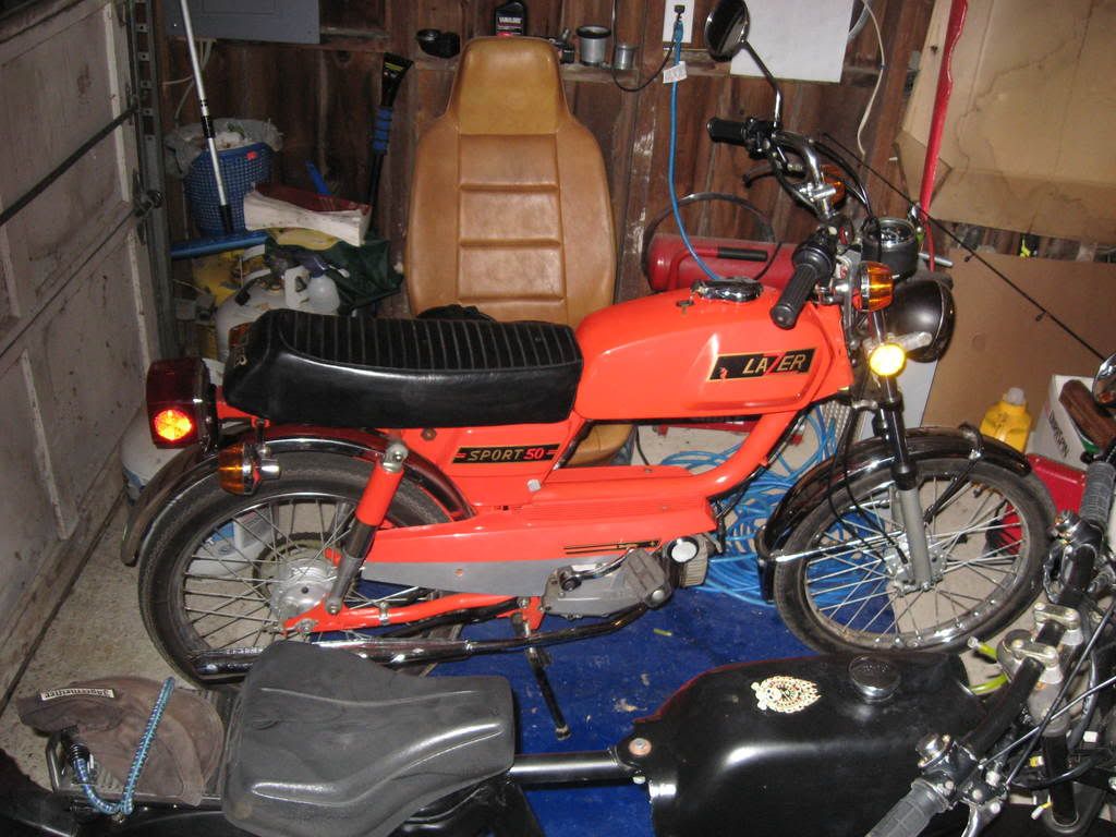

I just recently picked up a nw bike for the lady of my life. I want to put a kit on it (so she can keep up) but want it to pretty quiet. Has anyone put a kit on aand kept the stock exhaust and carb?
The bike.

It has a V1. I think with a 75 or 70cc kit I could get away with the stock carb? My other bike has a 70cc kit and it said in the instructions to use a 14.12 carb with a 54 jet!! (Polini) I just wonder how it would run with the stock pipe mostly. I did not see a big difference when I added the super loud mamba to my bother bike when it had a stock bore. The stock pipe has a pretty good size header and is not nearly as restricted as my stock pipe from my other V1.
