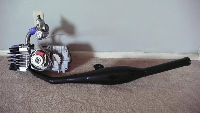

Still need a few finally touches, but hopefully it will be on a bike by the end of the day.
-Gila - lots of port work
-24mm mikuni flatslide
-custom intake
-v-force 8 petal reed cage
-hpi race ignition
-Motomatic Doppler Copy puch pipe (yeah it aint no 8p suckas)
I am not totally happy with my port matching job. Kinda shitty. Oh well. I have two pistons I am gonna try. One slightyl modified stock one, and one with a window cut like brando v1.0. Gonna give both a shot. Just have the stock one in now to tune it and see how it runs. I'll post some cylinder pics later on.

wow ! thats going to be scarry fast

thats beautiful. I want to see it go go go .

thats a lot of money to blow up / go warp speed.

Wow.... I hope you've got some brake upgrades to go with that engine :|

It is a lot of money to blow up, but hey, whats the fun of building crazy stuff if you cant got crazy on it.
Luckily, I bought all this over a long period of time, and when I stil had a real job, so it didnt set me back too much. Also, the only expensive stuff thats gonna blow up is the kit and maybe a crank. The other $$$ cant really break.
Full speed ahead.

What case is that on the right? And awesome that you finally have the Gila together Tommy.
