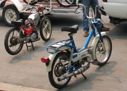

Fuk it. Nate makes sick Bats

isn't that a solo, rafter?

thats a batavus badger. they do look similar to a solo.

wtf pipe is that on that badger and how fast is nates and what did he do to it

yeah, stats on Nate's badger would be nice. I didnt know nate fuked w/ batavus? im dumm.
