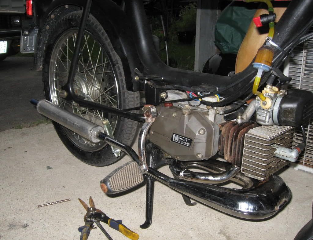

Like I said the Estoril has been good to me.. when I had a 75cc Polini kit with a 16 SHA I was hitting 44.. but then I blew it up because I down jetted a tad too much (spark plug chop lied to me I swear!)
Does anyone know if the restricted thing about the Estoril is true? (http://www.mopedarmy.com/wiki/Tecno_Estoril) I don't really want to cut it open and find nothing there.. welding isn't hard just rather not mess with the integrity of the pipe if I don't need to..
