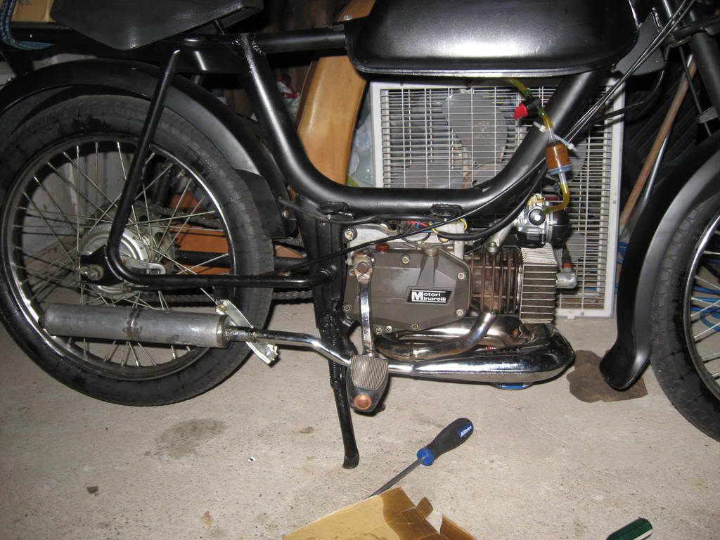

I've been working on tuning my Minarelli, and the max I've managed to top out at is 35 mph. I feel like I should be doing better than that by now. Here is my setup:
Dellorto 15.15, #60 jet
1977mopeds 15mm intake
Port matching on the intake (my first porting)
Mamba exhaust
11 tooth front sprocket
Ignition timing: 50 degrees before TDC
I've tried different jetting and different ignition timing and can't get an improvement with either. I plan to do some real porting at some point but I thought I would get faster than this without that. The acceleration is pretty good, not amazing at low end but really good midrange. The only things I can think, is that I need to double check my compression. What should it be? I haven't looked at my clutch, I dunno if maybe its slipping still at full speed? Or my points are worn out so thats why the timing needs to be so advanced?

yep, widen it and raise it just a bit, but don't lower it(don't cut towards the case, only towards the head) and you'll see instant results, I raised mine about 1.5mm and widend it to about 60 percent of the bore, then polished it and matched it to the headder, and wow, 40-45 easy

BTW this is all the porting I've done so far, opening up the intake.
Re: Shouldn't I be going faster with this setup?
MORE! Make a transition from that to the port. that's not doing much
