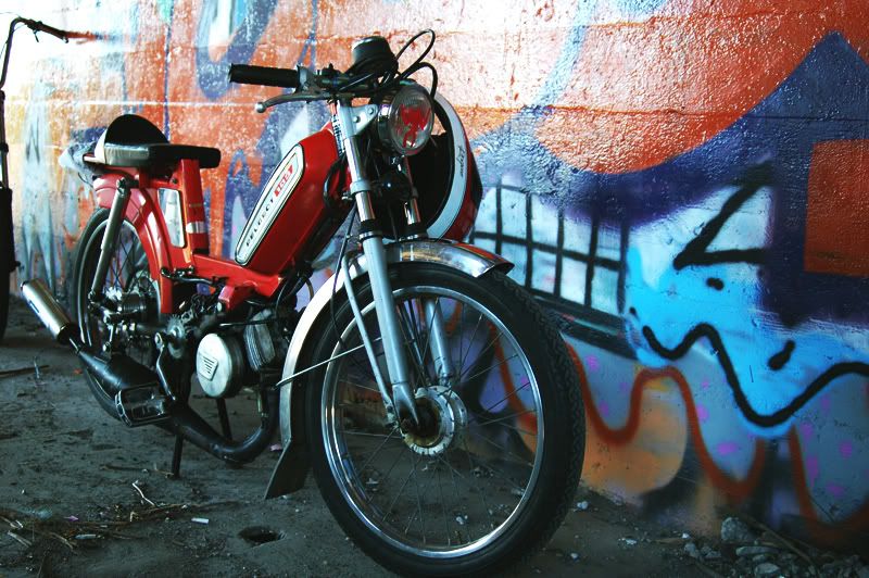

Id love to know more about that green one and jorlando, that seat looks bamazing..did you do that yourself?

it's a lambretta seat imported from germany. 60mph+ bike. malossi case, long stroke crank, 70 gilardoni w/ customized ports, 21 phbg, huge 4 petal intake, high flow filter, doppler pipe, malossi multivar variator, 11:38 gearing.

orlandos red bike shreds HARD, i wouldn't be surprised if its 60+.... even w/o with his new stroker crank kit now.....
watch out power central.
Re: pics of fast peugeots
It is certainly geared high
i'm pretty sure 38 is the smallest rear sprocket made for peugeot. and I still can't take off with WOT cause the torque will rip my engine off the swingarm. last time I tried it ripped off my pipe bracket and I had to reweld it with thicker bushings. it's a dangerous bike.
