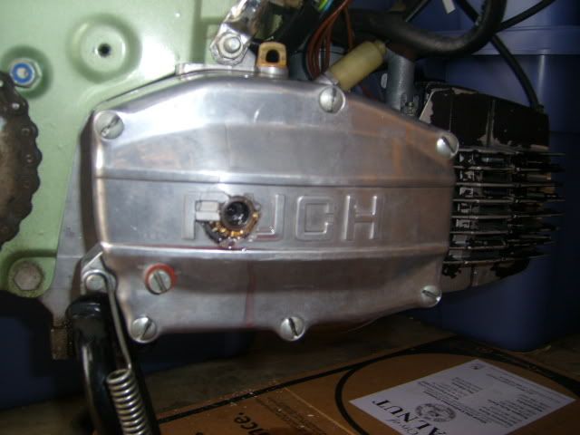

Tyler Jacobson /
i just rebuilt one. i took a bunch of photos and hope to be able to make a wiki entry with them. it is my first try. i havent run the engine yet because im trying to set up the internal ignition coil.
