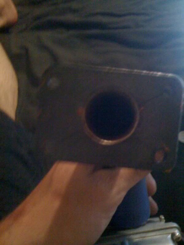

pretty stoked on my new gilardoni last nights rode with other mopeds and was doing about 50 mph? with 15x 45 gearing!
B & R prototype: Matches a 21 dellorto mount perfect This will add some speed for sure. did a simple volume test and its about a 1/3 less then standard intakes! i think i can get it to 1/2 with shortening the pipe. matched the reed stuffer and intake for a direct shot to the reeds for maximum velocity and the least amount of turbulence. If interested in one email me.

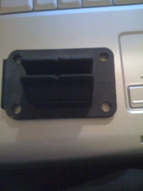

where did u get the stuffer, rafter had one too.
Re: custom gilardoni intake
🇮🇹💦 Of the Loin /
my stuffer came with the malossi vuton reeds.
it didnt match up to the doppler intake so i am not using it.

There are 2 aftermarket Malossi Reed Cages both have have stuffers. I think spending the $$ on the "Veton" reeds is a good investment with better sealing technology for the reeds and a better stuffer. If i was loaded i would get a v force

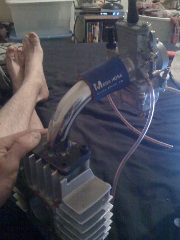

euro ie:
Hellarad Johnnny Johnnny /
that exhaust mount is awesome. dutch twine technology?
🇮🇹💦 Of the Loin /
haha, thats not an exhaust mount,
if you look closely its the throttle, and unless that picture is a mockup, he controls the throttle with his foot in that loop!!

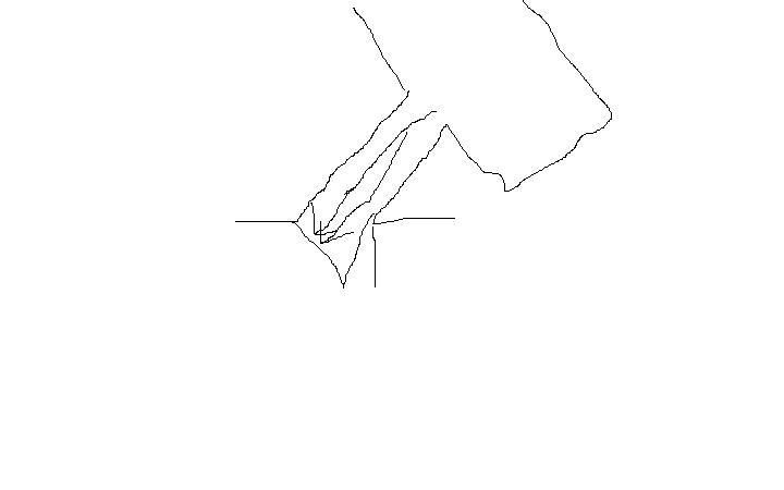

I would say from what I have learned from shaw (who has read bell and jennings multiple times) that those intakes are all terribble examples of how an intake should work. Here are some drawings I made in 10 seconds each. Sorry for how horrid looking they are.
http://img.photobucket.com/albums/v152/ohdojo/bad.jpg
Its all about fuel flow, and making the fuel be able to flow as fast as possible, if the gas has to change directions and hit blunt edges it wont flow as fast as it could.
This is just what i picked up from reading bell and talking to shaw a lot.

oops.
heres the bad one. the one above is good.

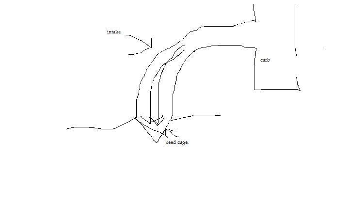

hmm... now that i think about it just reading about this wont tell you everything, there will be a reverb on reed intake also just not as severe. Because the reeds close when there's a mixture going down the tube because of the compression stroke before the transfers are open. It would be nice to know mathematically a tuned length for all the kit intakes.
But Its not that easy to find the right size pipe that are bendable and you can weld so i think this one will be pretty good:
heres a drawing of it ( rainbow penis! hey its pride Week you should try it!...)
red intake
blue - reverb when reads close
purple - intake and reverb cause eddies actually there would be lots of eddies everywhere for a time period
green - bad flow

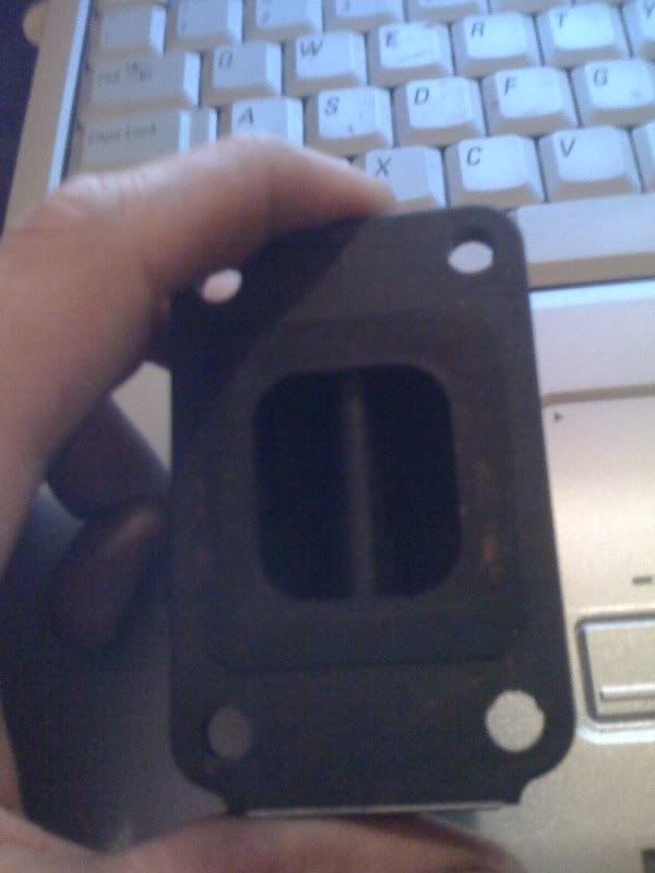

Ok heres my shit.
Oh, 8 petal reed cage. No biggie.
Stuffer. duh
