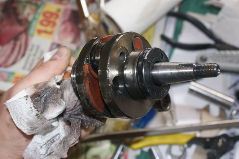

I had this one in a STOCK Cylinder 50cc and ran it for ONE DAY, maybe 25 to 30 miles.
Nothing a rebuild cant fix, but damn, a fresh rebuild and 25 miles?

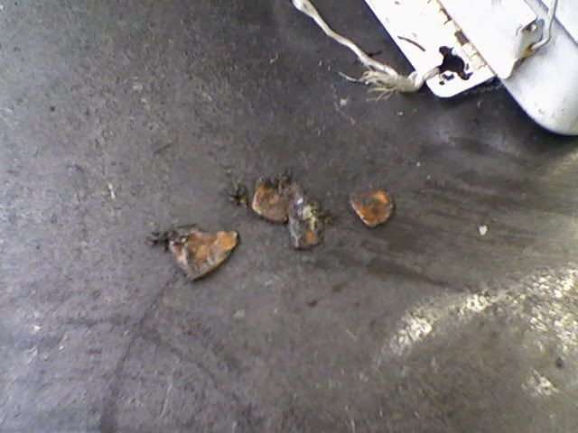

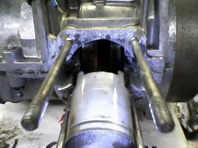

Notice anything missing? Right side orange material is gone :(
Oh, I think I found some of it here, hiding inside the piston :
And here is what I pulled out of the side transfers and such :

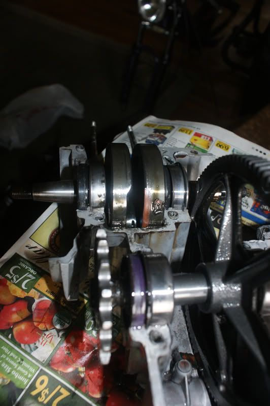

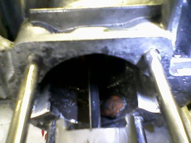

I have taken more pictures as I disassemble the motor, and its not pretty.
If you look close, there is a piece of the crank material under the main gear.

How would it get in there. I thought those sections were totally separate. That is odd
Re: Problems with DMP cranks ? !
Could have happened when I split the cases and didnt notice it fall in there.
Crank itself:
