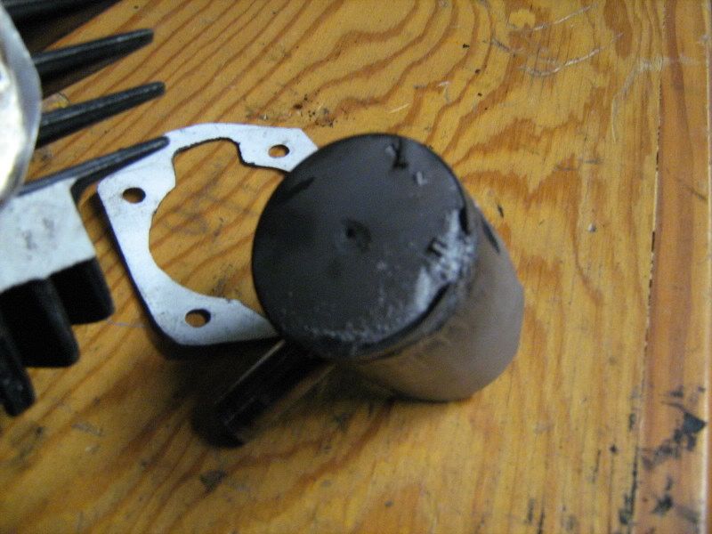

This piston is the result of timing too far advanced. Similar results could be expected from too high compression.
