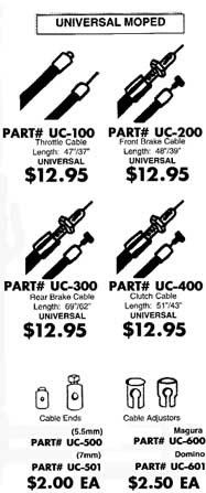

i need this, too, right?
<a href="http://www.flickr.com/photos/26512291@N03/2488411210/"; title="Picture 8 by ronnyjamesdio, on Flickr"><img src="http://farm4.static.flickr.com/3178/2488411210_13a8b13140.jpg"; width="329" height="236" alt="Picture 8" /></a>
Re: magura throttle and dellorto carb
Brian Smithmeyer /
I have the same problem with my stock puch cable and my dellorto carb. I plan to do what ar71c40k3 said with the solder trick. I tried two adjusters, but it's really lame and hokey. I'm actually surprised more people don't complain about this with all the dellorto/metra kit setups people seem to be buying these days.
I have that Magura throttle setup on my bravo and it's a slide throttle. Is that what you have? Does yours have the slide that runs left to right when you twist the throttle? Maybe it's just missing the screw? You can get a screw at the hardware store.
You souldn't need the L 84 pinch bolt posted above. That won't do you any good.

I have a throttle on one of my bikes that requires a double ended cable. I use one of the 5.5mm cable ends shown here:
They are available at a few different places. I think I got mine at Moped Junkyard when I was ordering some hard to find parts for a Garelli. The 5.5 mm size works perfectly, though.
