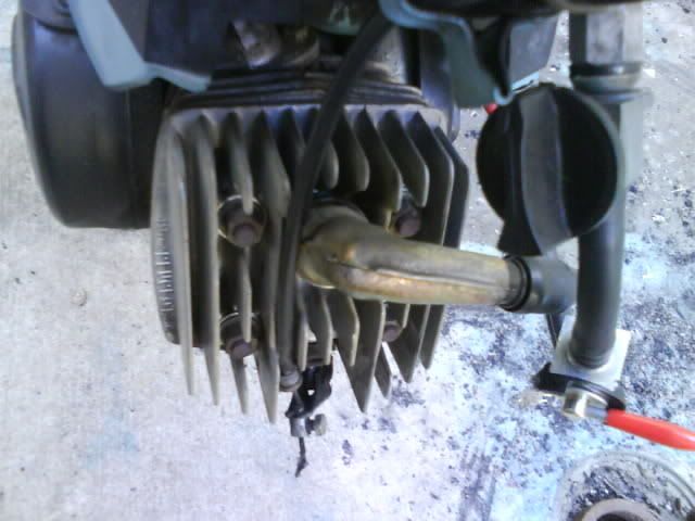

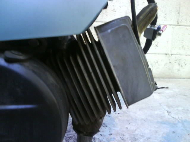

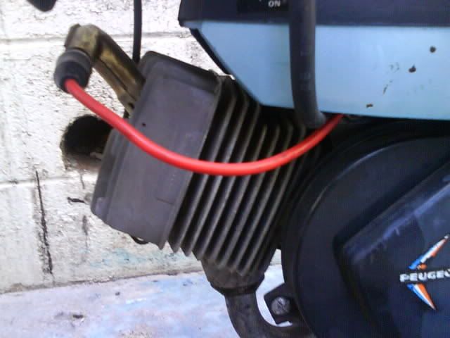

can someone post a close up picture of the motor from both sides.. I might be able to get a couple cylinders for them but they want to make sure we are getting the correct ones.
Fred
Re: Peugeot 102sp needs to keep up
Thanx freddie! that would help so much!
here they are...
!http://i136.photobucket.com/albums/q176/korpseharvester/ATT574963.jpg
is that a piston port?
fred
not sure what else you need fred? can you be more specific?
what do you mean by piston port, I took pics of the motor, both sides and one of the front.
I had forwarded the picture on to my overseas friend and they came back saying they had some. due to language issues sometimes I just wanted to confirm. where does the intake manifold go into the motor
Fred
102's are piston port
this guy has a bunch of pics under custom, cant remember his handle, but i remember him asking questions about it.
i think they have some sort of crazy gurtner or something stock.
