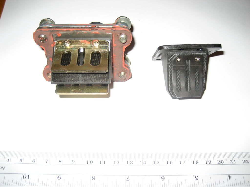

Got some pics I'll bust out the calipers tomorrow and get better measurements tomorrow. It is just a pieve of aluminum 8mm thick and the only three critical dimentions are the two smaller holes which hold the pads the cheeks hit and the center hole which is tapped.
Front
Back
Re: Bidalot
Well that would be a malossi 4 petal adaptor reedblock vs a minirelli AM6 reedblock....hmm interesting

I think 8mm plate stock is the ticket for making a new one I just got to get the dimensions.
Re: Bidalot
Yeah, someone needs pretty much all the numbers if they are going to make one. You could also send one off or take one to machinist and have them make one. Something made out of a billet of aluminum is of course going to be much stronger then a cast part.
Re: Bidalot
Actually, as long as you don't mind it being homemade looking, all you need is a flat plate with a big hole and two countersunk small holes. You can make that no problem.
