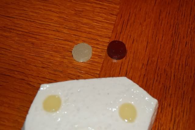

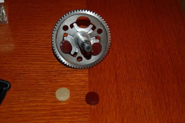

Alright folks here is a heads up for those kitting a za. After about 20 years or so, those tasty looking red shift dampners in the ZA50 2nd gear main shaft get brittle and fall apart and without them, your tranny will destroy itself. This was the case in a za I recently acquired.
Some fix it by using epoxy and hose or tubing, but I was weary about how any plastic or rubberized tubing would hold up in there so, here is my solution.
1. Buy a cheap latex mold latex mold kit from a hobby shop
2. Make mold of original shift dampner
3. Pour epoxy into newly created dampner mold
3. Let dry, and put new dampners into 2nd gear main shaft

What kind of epoxy did you use?
Re: za50 making new shift dampners
I have used epoxy for lots of things, never this. I would be concerned about the hardness and brittleness of epoxy compared to those dampers, but curious about the outcome in actual use.
My friend carved them from old skateboard wheels.
The stock one are just as hard as the epoxy ones I made.
epoxy when cured is harder than the stock dampners, the stock dampners gives(flexes) a little. the expoxy may crack under stress...heres some other ways to make, find some hard rubber matting or urethane and cut it to shape.

OEM ones or remanufactured ones? If It's OEM I'll pass they have been sitting around just as long as the ones I use to break all the time.
If it's remanufactured pucks I would be interested. I have been experimenting with epoxy of different hardnesses to adjust how the bike shifts, it would be nice to add another option to the bag.

do you guys mean urethane resin? seems like that would be much closer to the stock.
this business of tuning how the bike shifts.. that has me intrigued. does it really make a difference? what changes? i dont see how it could affect the shift point, but it could definitely keep you from shredding clutches/cranks/etc.

Rigid's
In fact the black set pictured in the image is of rubber matting. The set I’m currently using in my 76 is made of commercial spray-on truck bed lining (Rhino lining / Lava lining etc…..). My friend worked @ one of those shops and squirted some of that bad boy into a pie-pan to the needed thickness & cut it out later. It’s impervious to chemicals….. other than that it’s stiff and has held up to my kit.
I use other methods though- never ever weld the shaft & gear together in hopes of solidifying the shift.

devin that's cool...you folks are manufacturing some. hopefully it holds up better than the OEM. normally the OEM dampers doesn't hold on kitted bikes and peeps who has clutch work done on their ZA's...OEM will hold for a little bit, but eventually the dampers would just get shredded. when the bike shifts, with higher stalled clutches + kitted, will produce some great amount of torque and the dampers absorbs that torque while it shifts to second...and without good solid stiffer dampers kitted bikes would shred those dampers. for over 15 years we've been making it out of different material that'll hold up, against faster bikes, and absorb the torque. hope others have other ideas on making stiffer dampers....i use hard rubber matting in my za's and those have lasted me quite some time now. IMO polyurethane material is best. www.urethane.net could probably make some not sure of their prices. i'm sure there are others than can manufacture these. or if anyone in MA can make these out of polyurethane, let us know.
