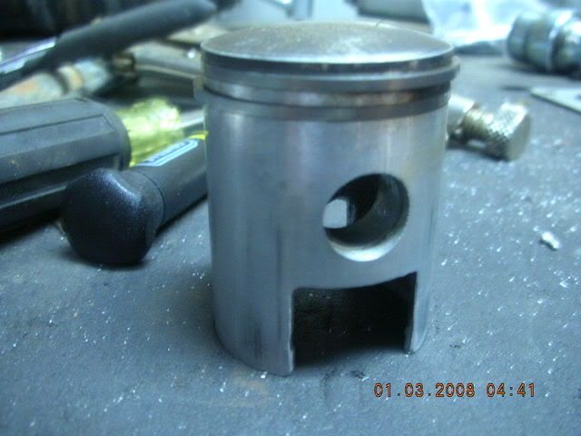

First I did the piston you will notice the sides have been cut down and chamfered.

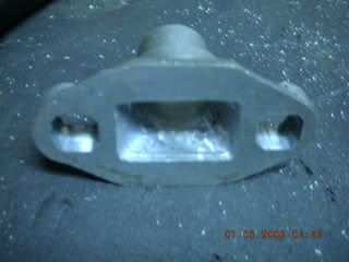

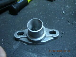

I also drilled out and blended my malossi short intake to 16mm and so it would match my dellorto.

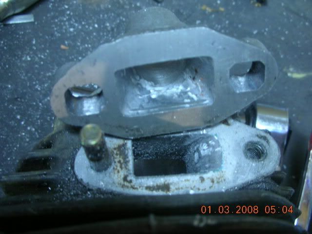

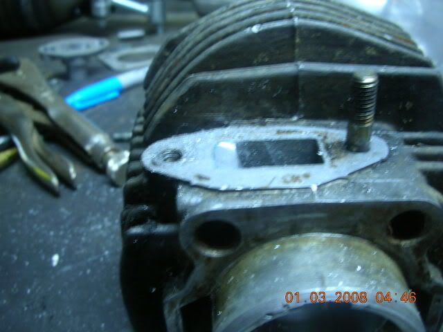

Now here's the cool part, if anyone has one of those short intakes they will notice that they don't line up with the port. So I matched the manifold to the intake port.
Notice that you have to watch for the bolt hole.
Also when I started working on the inside of the cylinder I took most of the material off the opposite side of the port in an attempt to maximize airflow.

I'm not sure on the compression but i decked it to the ring inside and am not running a gasket so what I've heard that is around 10:1. For the porting I mostly followed the blue page except i only took material off one side to get a better angle.
I hope this picture illustrates what i did clearly.
