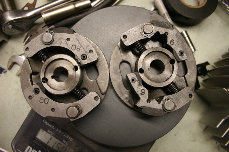

So I had couple of stock E50 2-shoe clutches laying around and I thought I’d try doing some clutch tuning this weekend. Here’s what I found out…
-The shoes stock are not a uniform weight, they varied up to 7g, this leads to vibration.
-You can’t turn the screws all the way in, the shoes will be restricted and you’ll end up with major slippage.
-80g is the lightest you’ll want to go; slip was noticeable at this weight but they engaged at a much higher rpm. They eventually grabbed but it took a pretty long distance to fully engage. Stock shoes were around 95g-102g.
-So far the best I found is: shoes balanced to 95g, spring screws 540 degrees out; this gave me slightly better then stock acceleration (not really worth the trouble for the minimal gain), noticeably less vibration (worth the trouble if you’ve got the clutch off already), overall it’s a good set-up.
I plan on tapping in a screw to the end of shoes so I can add weights; I’ll try some various weight set-ups to find the best. I’m thinking around 90g should still give me enough weight to grab and should allow it to engage at a high enough RPM to give me the acceleration I’m looking for, we’ll see. I’m also trying to find some heavier springs; this is really where gains are going to be made as you can only lighten so much before you start to get slippage. I’ll post more as I progress.
(Picture attached is the one with the lightend/balanced 80g shoes.)

This looks sweet Derek, I'm going to give it a try! Thanks for the pictures and good write up of theory! Wiki this bad boy!

With that much weight taken out, I have trouble imagining the clutch ever fully engaging. Maybe it does, but when I try to imagine the centrifugal force overcoming the push of the spring, it just seems too weak. Maybe I need to adjust my imagination.

i dont remeber the weight I took off. But if you are clever, you can do a buncha math and look at the pic to figure out the riddle.

I just cut down the first shoe last night to 80.7g. I pretty much did it like in the first pic. This weekend I'm going to try to match the other shoe to that.
Re: Puch E50 Clutch Tuning (2-shoe)
i cut my 2 shoes almost exactly like what rafter has drawn in his pic, in fact i think i drew the sharpy outline onto the clutch arm on the left last time i was in sac.
I have no idea if its close to 80g or not but i'm gonna guess not or that that statement is false, even cut that extreme they still engage fully eventually, however, the plate will wear out faster and the pins will begin to bend outwards causing all sorts of bad things to happen, on a daily rider don't expect such a clutch to hold up for longer than a month.
Also yeah u can do this to a 3 shoe the trade off is 3 shoes are heavier but they grip more consistently and harder. right now in my puch i have a 3 shoe cut similarly to this, however i think it needs to have more material removed cuz it just doesn't spool up as well as the 2 shoe did.

Elliot did indeed draw those shapes.

I weighed shoes with just shoe alone and no spring or spring screw and they were 98.8 and 98.5 . I wen't at it with a dremel and i was making very minimal progress for the time, so i decided to drill the shit outta the shoe. I put like 5 holes in each clutch and got them down to like 81 g, and put them on, the difference was pretty big. Acceleration was alot better and i could feelit spool up a bit. After about 30 mins of riding i lost pretty much all power, could only hit a top speed of 20 and could barely go on the flats . I took clutch apart and the little ring that keeps the plate on front of the clutch wasnt put back right and was just flying around over the clutch assemble, like in the back maybe were the gears are. My plate that covers clutch was also loose and beating around in there lol. So i fixed all that and put it back on right this time and also lightened my shoes to 74 g each, with sprngs at 540 out, so i will report back with how it is.
