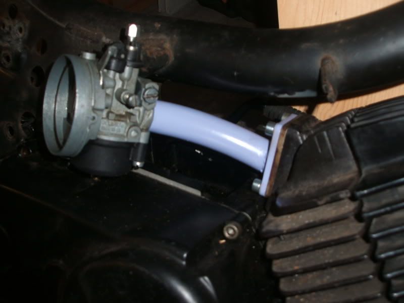

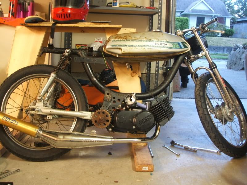

i made an intake for my a35

nathan, are you going to be at red october? terry, how did you make yours? I'd love to be able to rig something up...?
Re: tomos a35 intake question?
i had a stubby intake made from steel, i cut the stubby part off, bored it out, welded in a 16mm id pipe that curved out from under the moped, and welded it up. then painted it purple.

That IS sexy
