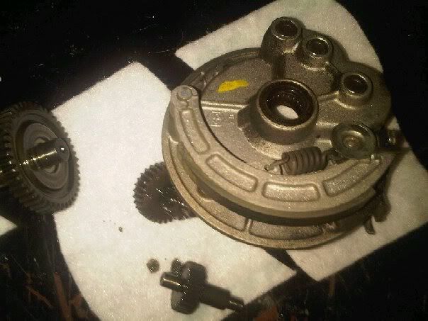

You're correct in guessing that's the way to get into it. Mine's a spoke wheel, but it's probably similar. That big nut should have been part of the bicycle freewheel. If I remember correctly, it's about a 36mm? Take your wheel to a bicycle shop for a replacement bmx freewheel, and buy the matching tool to remove it for next time... Once that is removed, that bearing plate will come off easily, the gearbox will come out of the drum and look almost like this. Except your gears won't be spilled out to dry like in the pic. I'm kinda surprised that one single brake shoe can be effective at all inside of a drum brake! Take some gritty sandpaper and scuff that braking surface up, it'll have a glazed coating on it. Also, scuff up the inside of the drum's metal surface, it'll probably have some rust on it.

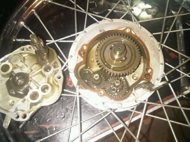

if you open the gearbox side, it will look like this. Pay attention how each gear fits into it's hole and aligns with each other, and also where each washer shim goes. And the spring on the main cog. Notice how that main gear's disengagement works. This is a PERFECT time to drain out that 30 year old crap and replace it. I used synthetic SAE 80W/90 and will probably never have to touch it again. Unless it leaks someday. I'd put some of that in and give it a few hours or a day to see if it's going to leak. If that inner seal leaks, it could coat your brakes and give a pretty bad ending to your day. I was lucky that my seal was good and the outer gasket came off in one piece and was worth reusing... with the gearbox in it's correct mounted position, on or off the bike, fill only up to the fill plug hole. This really isn't a difficult project, and you'll be happy that it's all inspected and like new again.
