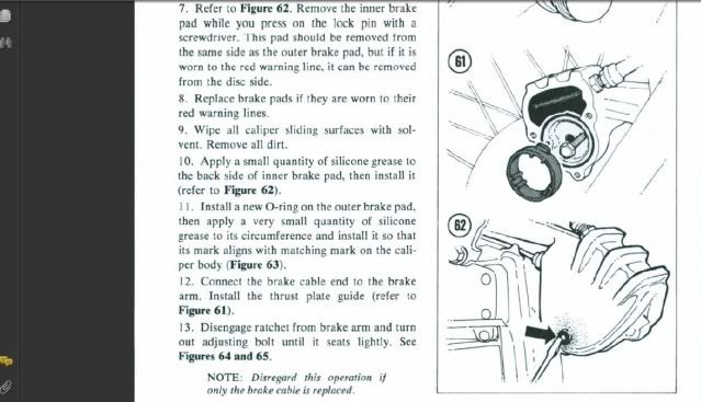

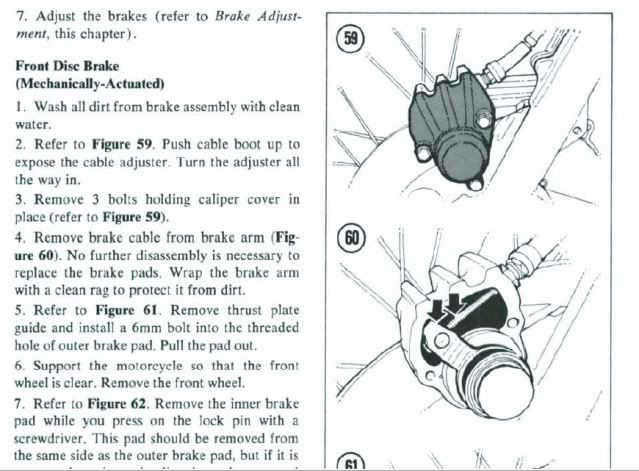

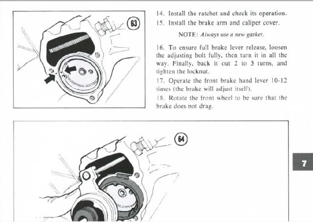

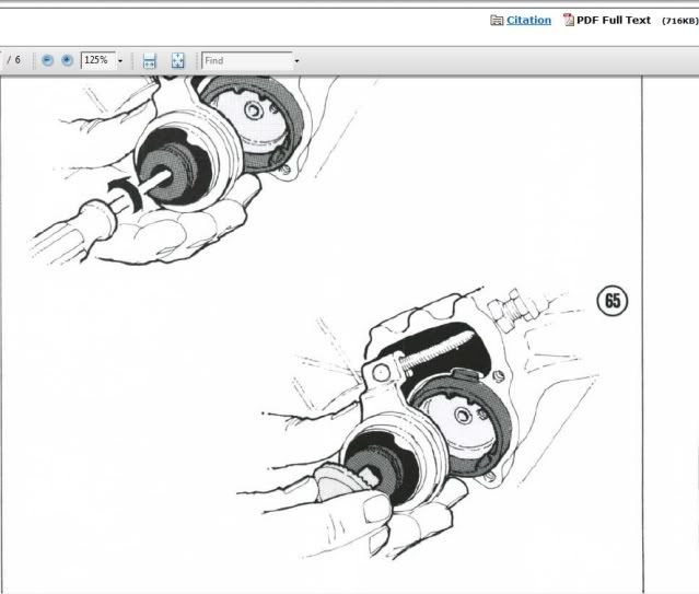

Dominique, the CB125 and some other smaller Honda bikes had mechanical disc brakes, no hydraulics at all.
Re: Honda cb125 disk brake question
also thank you for the pics man! i looked on DTT and couldnt find anything this good, just complaining about the setup and converting it to something else nothing about fixing it up.
