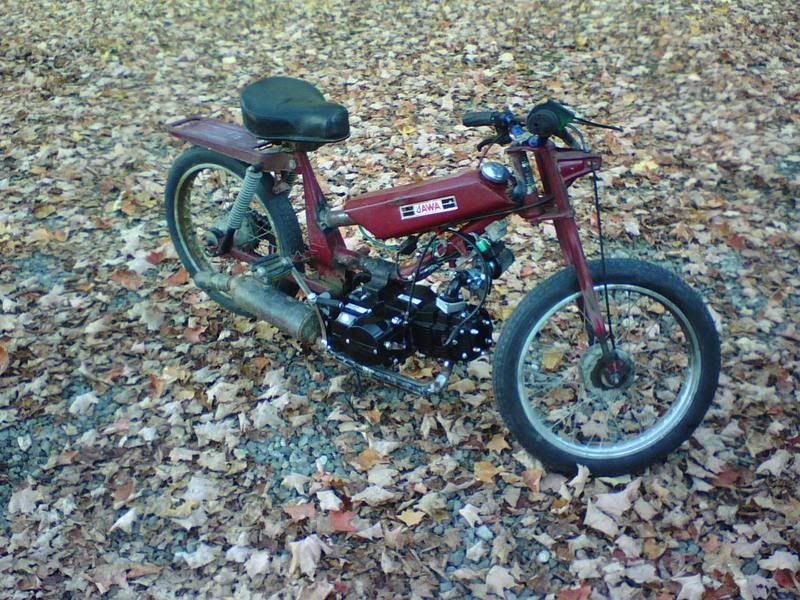

the jawa swap. alive.
ok.. update.
the jawa is now up and running with its 125cc 4stroke 'power'plant.
Although, i cannot say its finished yet....
still have to get some brake cables, wire up the lights, and replace the tires.
but! it runs..and it runs great.
took it down to the airport and rode it for about an hour to break in the engine..
sadly, as of now...it is a 'noped'
but im keeping the pedals on it because i like the bicycle stance it has. and maybe i can figure out something to reconnect the pedals

Holy shit. You actually finished it!
That's amazing!
Video footage? Top speed?
How's the shifting?

i didnt have a helmet at the time..plus no brakes. ha. so i didnt get it up to top speed yet. (that and im honestly alittle scared still)
but im planning on taking it back down wednesday and seeing how fast i can get it going. ill have a friend film it as well.
I was going to post more pics...but this camera is working.. all i have is my cell. lame :(
and shiftings fine. Just have to get use to shifting without having the leveage of a foot peg.

You could rig the pedals to be the shifter, or the rear brake.
Re: the jawa swap. alive.
I may get flack for this but..... If you have a manual set-up like that its best to run with pegs rather than peds. I dont think there is anything wrong with removing pedals for performance and I know there are many like minded modders on here that would say the same thing. I would only run them if you have to for legal reasons. I know around here cops wouldnt notice or care if they did. I agree get vids and more pics up fast, preferably nudes.

did you put extra support to protect that frame from that monster engine? omg that thing is flat out ridiculous. i want one. now. that is awesome.

I think that you should purchase a front wheel intended for a Honda cub, or Honda Nighthawk 250. The final wheel size is really similar (maybe a big bigger), but the brake drums are much bigger.
The mounts will be different, but you've been down that road already...

my friend brought over some cables last night that i was going to put on, but turns out those wont work either. :( so either way, im still testing it out tomorrow (wednesday) and video taping it. brakes or no brakes...
i guess ill just have to wait to see how well these brakes do when i get them working. im really hoping theyll be sufficiant enough.... cause honestly... im getting tired ha... ive worked on this bike practically every day for the past three weeks.

I would seriously consider throwing some late model jawa 210 forks on that bike. The fork inserts on those bikes are extremely shity and fragile. I once dropped one of those fork inserts from 3 feet up onto a wood floor and it broke clean in half. The later model 210 forks are much more substantial and should fit right on that.

haha yeah, mine are like the size of a quarter diameter in thickness.. Its scary as hell. they also only have like an 1 1/2 of play as far as 'suspension'. its kinda sad. Little mini bikes have thicker forks. hell, my bmx bike is probably 20 times stronger.
do those 210's have larger drums as well?
i might be able to just replace the entire front end.

Brake diminsions are 85 x 20 mm.
At least thats what the 210 manual says.
Actually, looking at the exploded diagram of those later forks....they are not that much better. I'd feel slightly safer on them, but not much. Maybe some EBRs will fit?

is that the trusty ol' lifan 125cc 4 stroke?

yes..its the trusty lifan haha.
