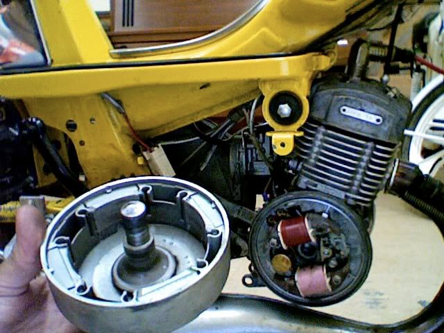

so i'm riding my 50v, happy as hell. just did a plug chop, looks like a delicious cappuccino. everything is right where it needs to be, the world seems to have this warm blanket over it. all fuzzy and cozy, like a big hug from the universe. i love this bike immensely. i mean really, its up there with my favorite things in the world. there is nothing i wouldnt do for her. anyways..
i take a right onto oneta street and i'm thinking, "yeah, i'm going to open this up and scream past all the chicken plant workers". so as i round the corner i pull back on the throttle and hear the worst noise in the world coming from my magneto, like two babies beating a puppy to death with frying pans. i look down just in time to see my magneto fall off and roll down the street faster than the rest of the ped. what the fuck? not in front of the chicken workers!! but yes.. fucked. sheared my crankshaft right in two. so i picked it up and throw it in my backpack like that was my plan all along and push the moby home in shame. the jug is fine, it didnt seize, i'm thinking that it was just its time to go maybe. any ideas on why the hell this would have happened?

damn man! too much power on a not so great crank, i guess. maybe it was the crank, maybe the bearings... i dunno. looks like a fairly clean shear to me though.
treats sells new cranks, id look into one of those. if its quality is proportional to its price, you should be all set on crankshafts for a long time.

Also known as
"How to remove your flywheel without a puller"

fuck cdi i run av7 magneto points system on an av10 no problems at all, with doppler crank and av10 nut.
btw that happened cuz ur bearing on that side went bad. looks like it was time for a rebuild. now its defiantly time haha, like how mobys tell u these things, a puch would have happily continues on it merry way till the bearing seized up and ur motor locked ur rear wheel.... u could have died.... if u had been on a puch AHHHH!!!!
lol, check ur bearings like u check ur balls. and if ur run a 2 ball variator that's not balanced with a 4 ball plate this will happen alot.

the variator is stock for now. that was going to be my next mod.
doppler crank huh? i was looking at the malossi that treats has. any thoughts on that? where can i find the doppler? no luck searching as of yet. yeah, its obviously time for a full rebuild, ha! i have another AV7, thats why i was considering building an AV10. the cases that treats has come with bearings seals, the whole nine yards. i heard something about mounting an AV10 to a 50v frame can be a little troublesome. what am i in for here? cause the AV10 thing is going to happen like right now.
