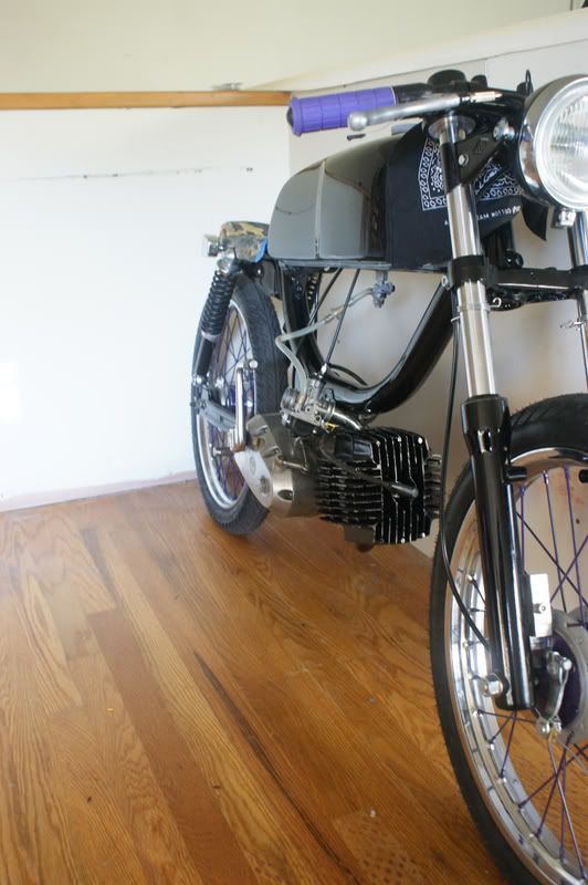

West Seattle’s new toy.
Only things left to do are :
Wrap the seat pan and put the pedals on. ( yes this is a moped )
Specs:
Puch KROMAG frame converted to top tank. ( Wrapped and reinforced )
Puch MURRAY boxed swingarm
Puch MONZA 50cc 4 speed manual motor ( stock for now )
Tomos Sprint front forks
Sachs General 5 star front wheel ( sealed bearing)
Puch rear ( sealed bearing convert )
Aluminum motorcycle clip ons
Top Secret motorcycle tank
Hacked up moby long seat pan
New steel pedal shaft/sprocket fabbed by west seattle/mike mike connection
Cut up 6p
20mm PHBG
Runs, rides, and will be seen at a rally near you soon.
Thanks to:
Jeremy Sullivan ( west seattle )
Mike Mike, for use of his shop
Treats benji, for super deals and quick shipping
West Seattle
Enjoy

looks fuckin rad Ryan!!!!!!!!!!!!! What the fuck bottom end is that, with the Magnum za50 top ?
Re: Step your game up/down 4 speed pics.
Hey Man that is sweet. what is that motor off of?
Ummmmm
Completely different motor tony, 4 speed manual shift PUCH MONZA

Thats kinda weird that the top end looks just like my Magnum za 50
The top end will bolt onto a e/za50 tho.... :p

"Top Secret motorcycle tank"
Norton repro? Looks good, whatever it is.
Sorry, meant BSA.
Looks fresh.

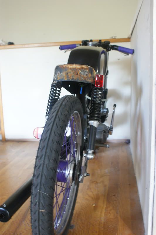

post some more pics when you get the seat on.

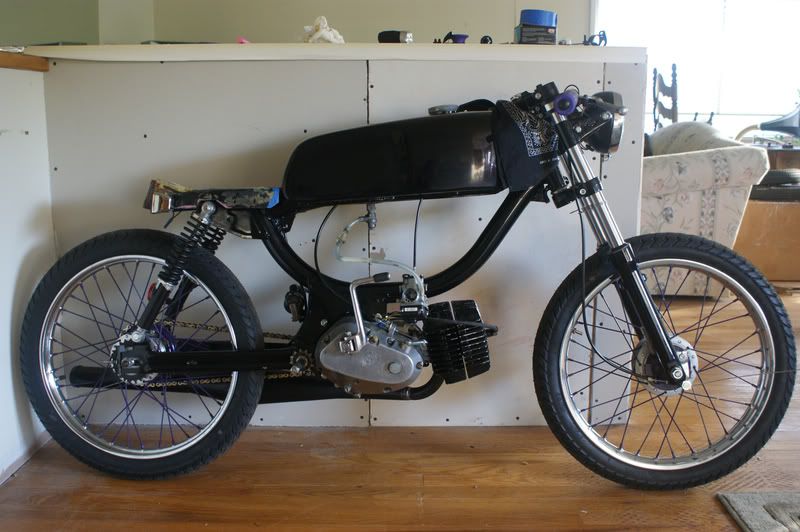

Cleats Onionpockets /
God damn you man! You beat me to completion on mine! Admittadly, mine wasn't looking anywhere near as nice, but I was doing the same thing with a 4 speed monza bolted to a maxi frame with a korado top end. Now I have to settle for being the uncool copycat.......fucker.
BTW, that looks awesome.
it's hard to see the detail he put into the wheels and everything else in those pics.. you guys are just going to have to come to blooddrive 666 to see it in person
Onion, I had it in a maxi frame to start with, but could not get the chainline to clear the frame....

I have been slowly building this for over a year and a half.

put pedals on it and finish your seat and send me final photos for Swarm!!!

Nice ride, total bulldog bike, and thanks for giving a peek to the gen forum. Now finish that seat!

Whered you git the forks??
they look like ebrs. you can get them from treats, mopedshop, 1977 mopeds, etc. not sure what size they are though.
you make that intake?
intake was hand made, the forks are new tomos ebr's
