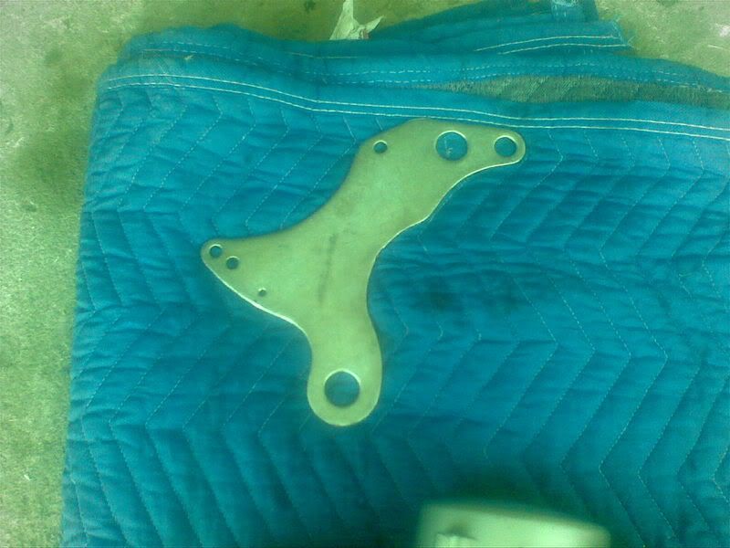

Here's some pictures, one of each side (I have the magneto cover off), and the last one is of the mounting brackets that were on it. It reminds me of some italian engines I've seen.

Lol, I think that's gona be the plan. The nice thing about the mounts is that I can put more holes in them, so I've already got everything I need to fab it up to an existing frame.
