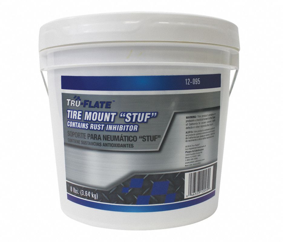

Re: How to install moped tires using zip ties
TOP GUN™ ANDY ⚔ (LSLB) ⚔ /
This shit slips tires right the fuck on
