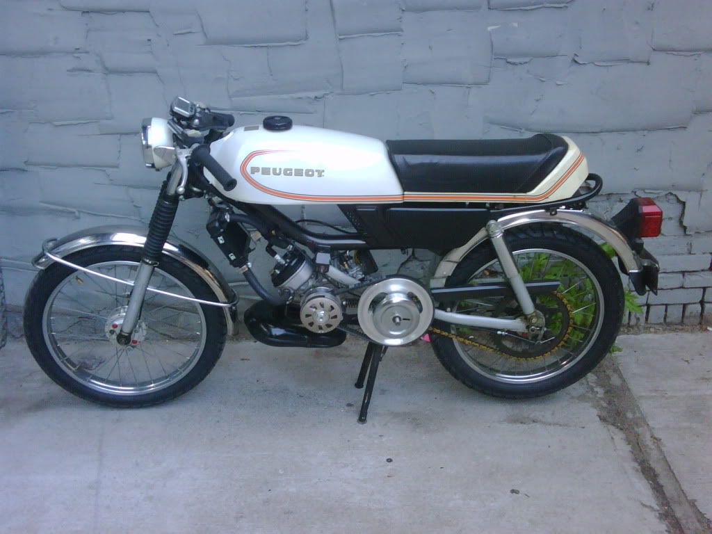

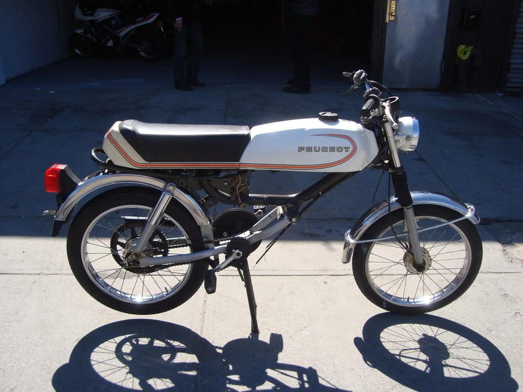

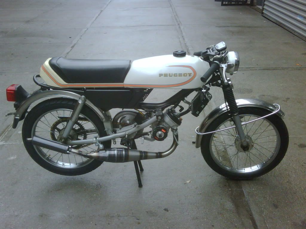

So...I present, Penelope Peugeot.
First day I got her.
Pretty much complete, with a different pipe on there.
Her setup, currently as of yesterday.
